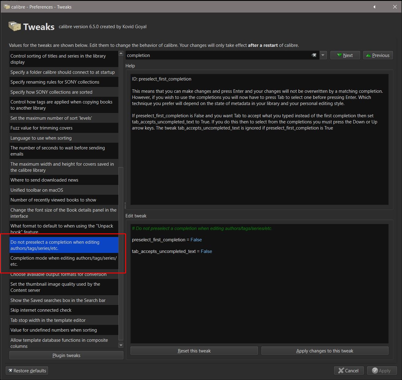

There are a couple of tweaks that can alter the behaviour of entering certain column types e.g. authors, tags, series etc:
Name:	Screenshot 2022-09-29 065641.jpg
Attachment 196843
Just tried this. Thought the True val for the first option was my issue but unfortunately it was not the solution. Thank you for the suggestion though.
