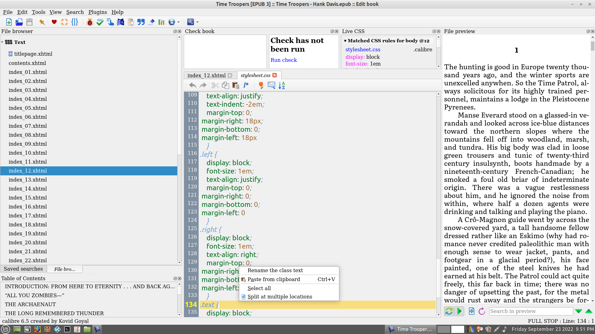

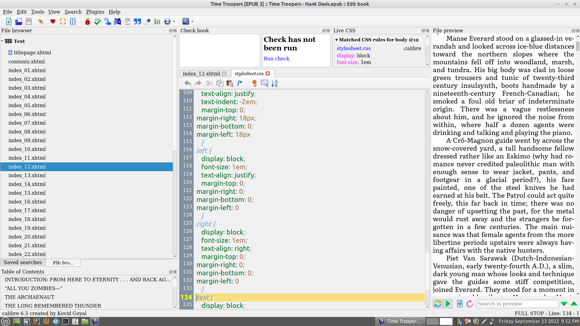

gbm
Posts: 2,300
Karma: 8891824
Do not high light the class place the cursor over it.
Right click get this:
Name:	Screenshot from 2022-09-23 21-50-01.png
ctrl right click get this:
Name:	Screenshot from 2022-09-23 21-51-31.png
ctrl left click get this:
Name:	Screenshot from 2022-09-23 21-52-33.png
*Highlight and right click the class name and get this:
Name:	Screenshot from 2022-09-23 21-59-55.png
*Works with text also.
