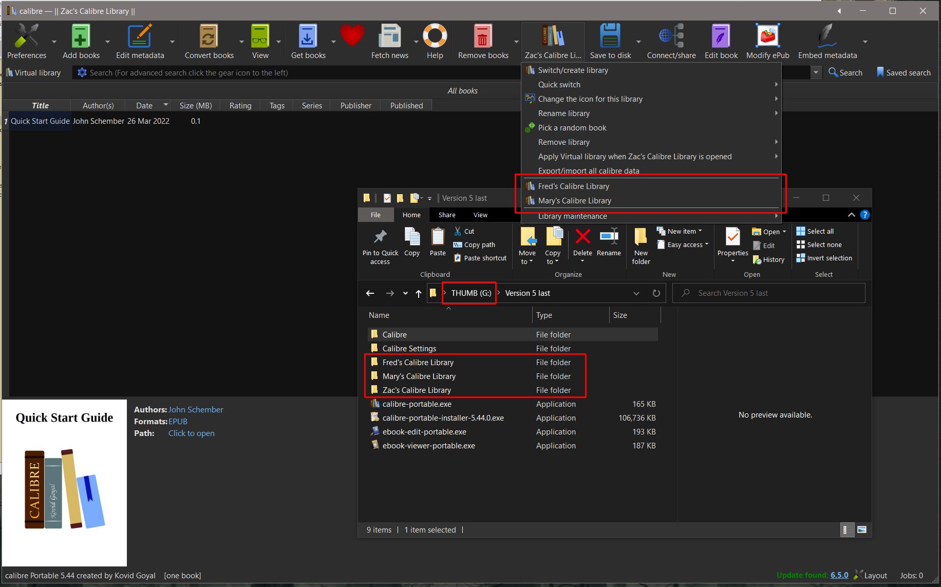

The DESIGN INTENT of Calibre Portable is that it be completely self-contained so that it can reside on a removable device that can be attached to computers over which the user has limited control - think libraries, internet cafes and slack workplaces. It will remember ALL libraries inside the Calibre Portable folder, but not those elsewhere - even on the same device.
See the attached image, I could post that THUMB drive to you and you'd be able to fire up its copy of calibre portable and access Fred, Mary and Zac's Libraries with my settings and plugins.
