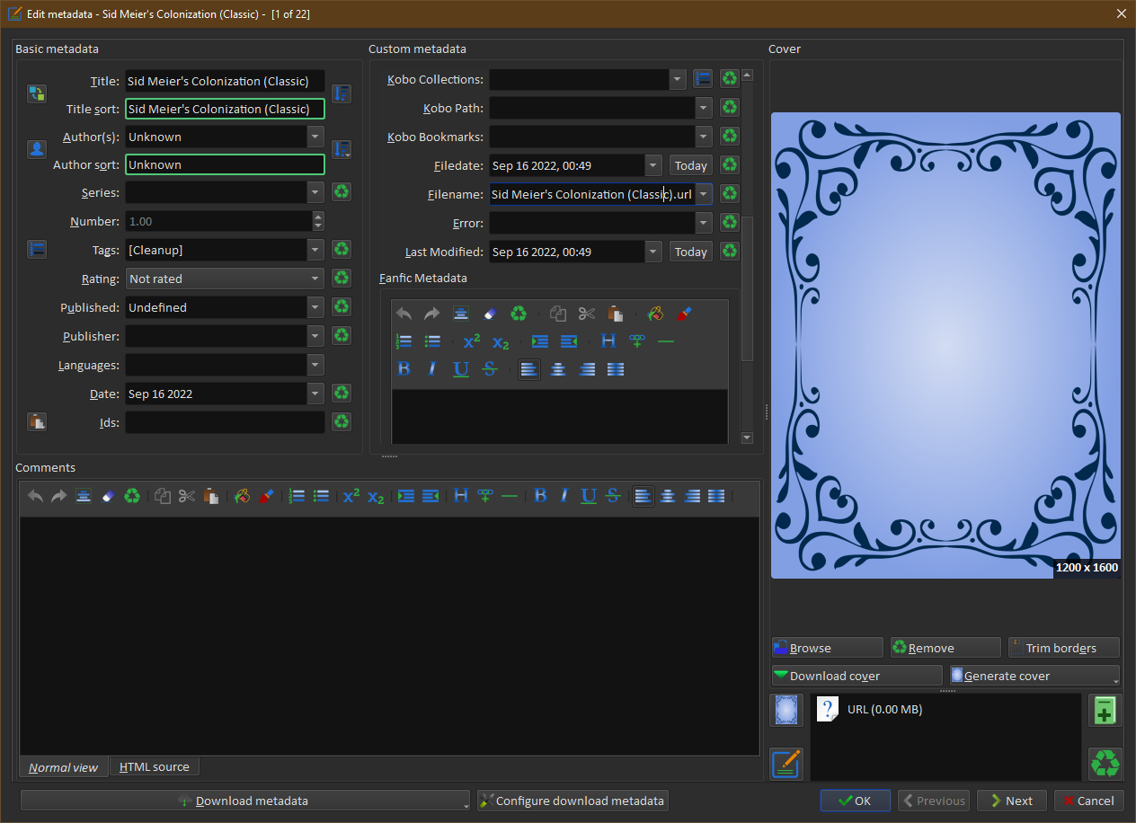

Another option, which BR's post made me think of: .url files will import intact (tested with a desktop shortcut generated by Steam), and you can use file:// to point to local files.
Name:	2022-09-16 00_50_06-Edit metadata - Sid Meier's Colonization (Classic) -  [1 of 22].png
