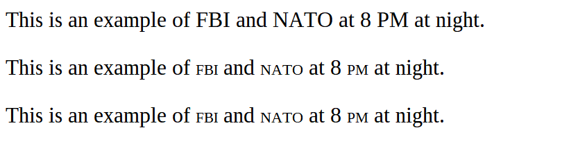

If, like Quoth said, you have oddities—like shrunken acronyms: "AM/PM", "NATO", or "FBI"—then it's up to you to decide what you want:
HTML:
<p>I worked for the FBI.</p>
<p>I worked for the <span class="sc2">FBI</span>.</p>
<p>I worked for the <span class="sc">fbi</span>.</p>

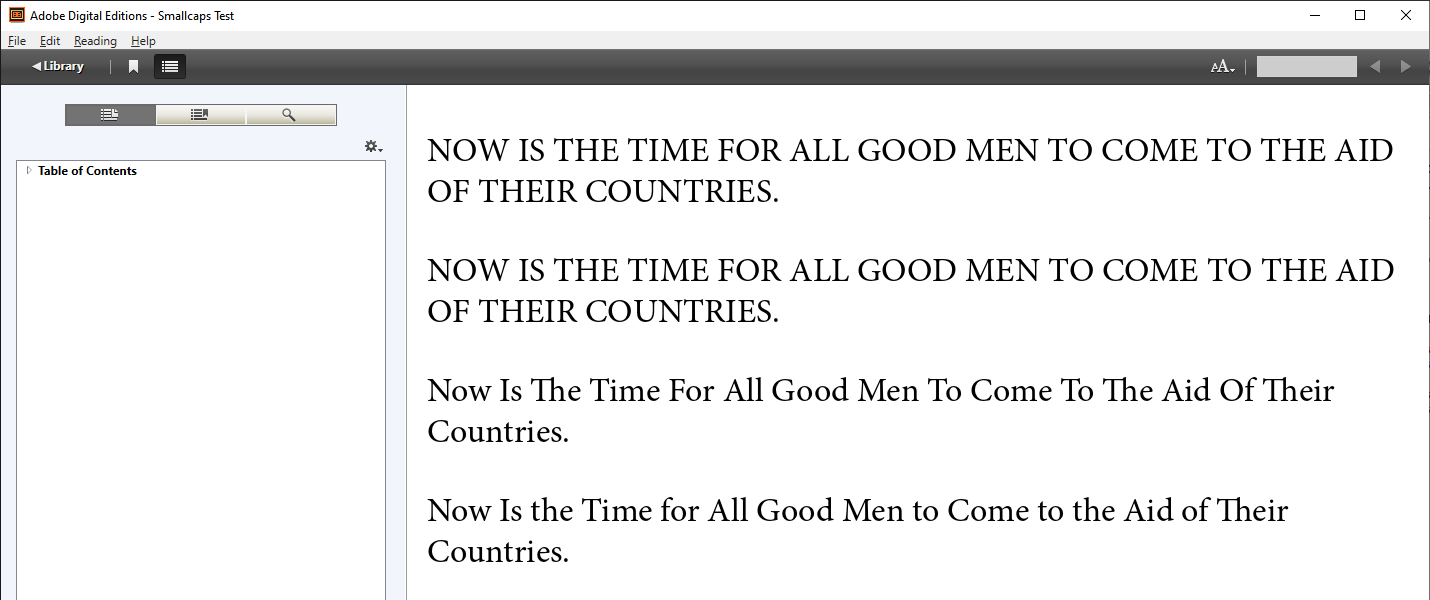

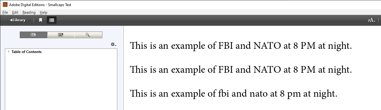

But, let it be known:
This text-transform shenanigans won't work on Adobe Digital Editions (4.5):
ID:	196518 Click image for larger version
so I would not rely on it for maximum compatibility.
