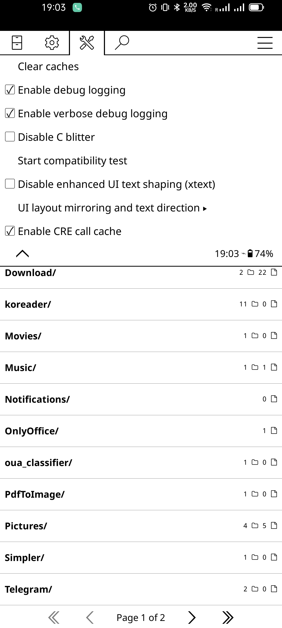

OK, I can't really tell a verbose log form a non-verbose.
Here I am again, this time I made sure the "verbose" square was ticked.
Thanks once more.

That's unfortunately still not verbose ^^ (really, get one from the Kindle, that'll be easier ;p).
