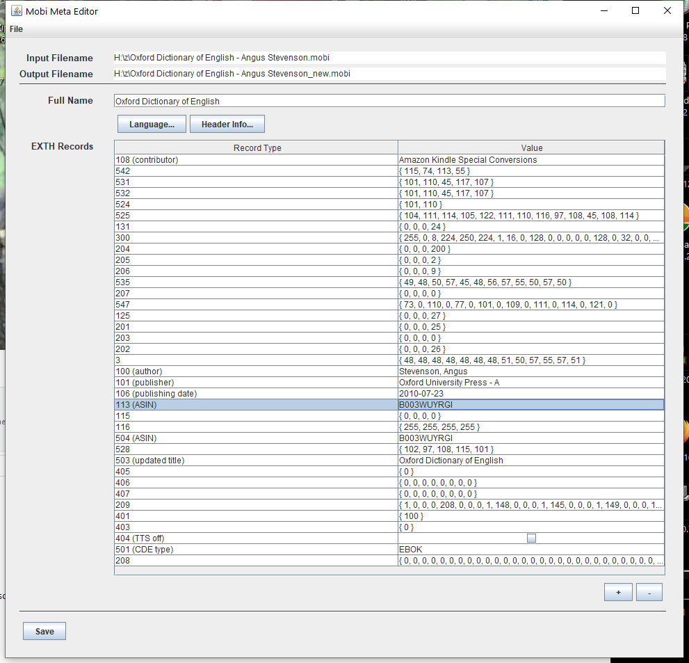

Any idea?
Unpacking this (de-DRMed) mobi7 dictionary:
Name:	Capture d'écran 2022-09-03 16.44.25.png
I get this error:

At this point the images have been extracted, a toc.ncx has been created, but no html content.

That error is most likely the result of a change to the array module in Python:
New in version 3.2: tostring() is renamed to tobytes() for clarity.
Added: I changed the name of that function in KindleUnpack and was able to unpack that dictionary without any further errors. I have attached a copy of the modified plugin in case anyone else needs to use it.

Thank you! Perfect
