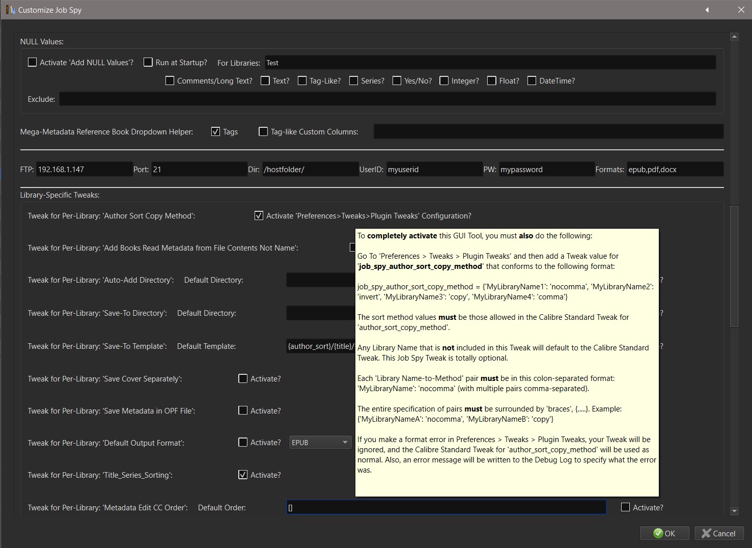

Name:	Screenshot 2022-09-05 204746.jpg
And if you want different options on different libraries, there's a per library tweak in the JobSpy plugin:
Name:	Screenshot 2022-09-05 204935.jpg
