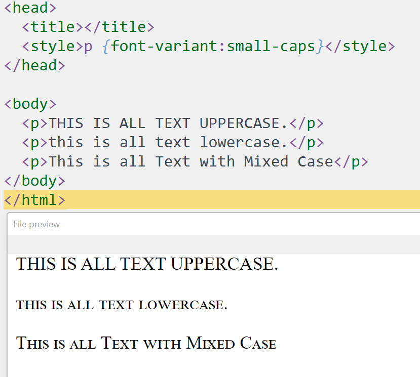

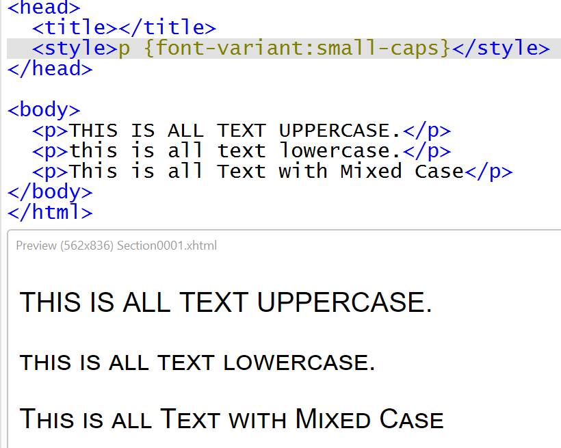

I'm going to have to disagree. If you have all the text uppercase, it won't work with small-caps. It needs to be lower case.
I've just tested this in the Calibre editor. I made a few words uppercase and then used a span around those words and a few others in lower case and only the lower case words were in smallcaps.
"small-caps"
You keep using that word. I do not think it means what you think it means.
Try using the following example in your testing...it works exactly as I mentioned in both Sigil and Calibre Editor (attached)???
    p {font-variant:small-caps}
  <p>THIS IS ALL TEXT UPPERCASE.</p>
  <p>this is all text lowercase.</p>
  <p>This is all Text with Mixed Case</p>
The first two lines appear the same (see attachments) - just with a different font-size.
The last line - with mixed case can be seen with the capital letters being larger than the lower case letters...but all of them using the capital letter from the font. And, yes, this is not a true SC font, but that's not the point.

@Turtle91 your samples are correct. The all uppercase is all uppercase. The all lowercase is in smallcaps. The text with the mixed case is both uppercase and smallcaps. That why I put text-transform: lowercase; in the CSS because if the text is originally using a simulated smallcaps, it's going to be all uppercase.
Smallcaps only work if the letters are lowercase.
