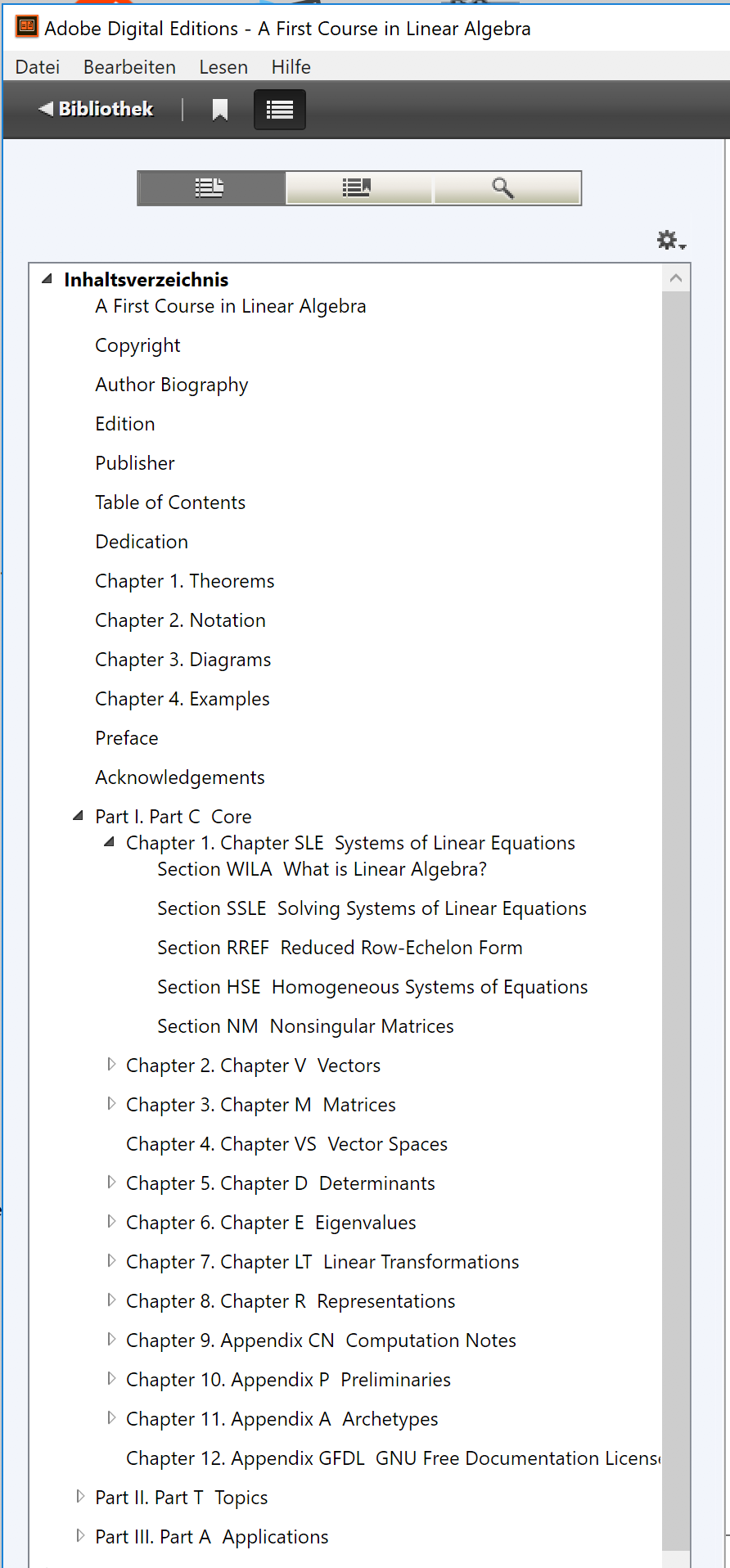

I made an EPUB with 3 nested levels in the TOC. In ADE4 everything is fine, but in iBooks, it's a mess! With the 3rd level starting, iBooks messes up with all deeper levels and after displaying level 3, it incorrectly shows level 2 as level 1 etc. (See screenshots attached.)
After hours of checking absolutely correct toc.xhtml code, I started to investigate this issue deeped by using the linear-algebra.epub of IDPF’s EPUB3 samples (https://github.com/IDPF/epub3-sample...linear-algebra). Loading this to iBooks brings the exact same errors!
So: Is this an iBooks bug? I couldn't find any relevant information about that in the web. Can anybody confirm? Or give me a clue how to solve this?
ID:	160177   Click image for larger version
