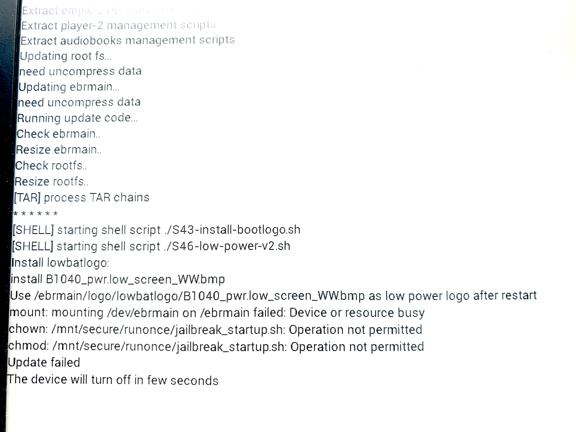

Ok, that was a good idea, but...
On my Inkpad the jailbreak ended with constant file-system-errors, strange things happened, so i wanted to uninstall it:
The uninstall never occurs, because on installing the jailbreak on the inkpad several things went bad silently. (I only wanted ssh-access, didnt activate other things). When i tried to uninstall the mentioned "Start the services again for uninstall" i only got "You want to install..." and the whole install occurred again. So i decided to look inside the apps - result is that they are shell-scripts, which looked fine in the first moment. But i dont understand many of the scripting but one thing that several things (folders) on which the jailbreak relies are not present on the inkpad. The mentioned /mnt/secure/.pkgver doesnt exist. Nor /mnt/secure/lib. The settings.old was never created on install nor the /var/tmp/backup_etc.
So every try to get rid of the jailbreak fails completely.
At last i modified the services.app line 75 from "exit 0" to "uninstall", to get a chance of any uninstall.
But some important things still rest somewhere in the system.
I tried to update the inkpad manually (first resetted the whole pad, formatted the internal storage and it ended in a notably bricked pad: I dont get a fully "new" install.
The firmware-update ends every time in "Update failed" and the last lines before "Device will shutdown in a few seconds" are somewhat like "permission denied /mnt/secure/runonce/jailbreak-startup.sh and two other permission denied messages. So before i deleted that folders manually, same as the /mnt/secure/runonce/*.sh /mnt/secure/bin /mnt/secure/etc.
To my sight all should be deleted, but in a to me unknown place exist one or more scripts which make the firmware-update fail.
Due to my last tries to get back a working device i dont have any log, but to get them i would install the jailbreak again to get them.
So if anyone here can explain which files get where installed to delete them manually i would be extremely happy to get that info, i want a fully working pad - ssh would be good, but that thing is something different, when the whole thing works again.
Jailbreak was the actual v8-16-g8f1fb88, firmware of the inkpad is 6.5.2920
Thank you all in advance
PS: See the pic i made from the update: The referenced jailbreak_startup.sh doesnt exist anymore! Where does that message come from?
igorius is offline   Reply With Quote

Hello igorius I just wanted to let you know I have read of your problem and would like to help, but it would take me some time to re-learn and find the info you need, and I am preparing for the imminent collapse of civilization at the moment.

I have a very similar issue. I had my device rooted just for SSH and now after the latest (failed) update touchscreen doesn't register any touch and I cannot really do anything. I've tried reinstalling the update by holding left + right + power buttons, but it fails in the exact same way. Though I can still access some most of the filesystem through USB.
Here are the logs:
swupdate.log:
 Firmware updateswupdate version: Jul 26 2022,07:52:24Searching for update image...Updating from internal memoryDevice serial number: XXXXXXXXXChecking update image...Found FW for device model: PocketBook740-2Image is OKFirmware version: U740-2.6.5.2917padding sectionunpack swupdateRunning update code.../dev/mmcblk0p2 cleanUpdating update filesystem...Running update code... 2  1 dosfsck run 2 and return 0mbr already patchedUpdate TouchFW ID=21 in 740Already 0x0103 Major '0x03' Minor '0x00'Extract DB management scriptsExtract empik-2 DB management scriptsExtract player-2 management scriptsExtract audiobooks management scriptsUpdating root fs...need uncompress dataUpdating ebrmain...need uncompress dataRunning update code...Check ebrmain..Resize ebrmain..Check rootfs..Resize rootfs..[TAR] process TAR chains* * * * * *[SHELL] starting shell script ./S43-install-bootlogo.sh[SHELL] starting shell script ./S43-install-bootlogo.sh[SHELL] starting shell script ./S46-low-power-v2.sh[SHELL] starting shell script ./S46-low-power-v2.shInstall lowbatlogo:Install lowbatlogo:install B740_WW_pwr.low_logo.bmpinstall B740_WW_pwr.low_logo.bmpUse /ebrmain/logo/lowbatlogo/B740_WW_pwr.low_logo.bmp as low power logo after restartUse /ebrmain/logo/lowbatlogo/B740_WW_pwr.low_logo.bmp as low power logo after restartmount: mounting /dev/ebrmain on /ebrmain failed: Device or resource busymount: mounting /dev/ebrmain on /ebrmain failed: Device or resource busychown: /mnt/secure/runonce/jailbreak_startup.sh: Operation not permittedchown: /mnt/secure/runonce/jailbreak_startup.sh: Operation not permittedchmod: /mnt/secure/runonce/jailbreak_startup.sh: Operation not permittedchmod: /mnt/secure/runonce/jailbreak_startup.sh: Operation not permittedUpdate failedThe device will turn off in few seconds
pbjb_install_log.txt:
I had exactly the same problem (Update failed - on jailbreak_startup.sh) and just fixed it.
1. SSH as root.
2. Look at https://github.com/ezdiy/pbjb/blob/m...s-installer.sh line 42
3. Run chattr -i /mnt/secure/runonce/*.sh (to get permissions to the file the installer gets stuck on)
4. Run mv /mnt/secure/runonce/jailbreak_startup.sh /mnt/secure/runonce/jailbreak_startup.bak (to remove the problematic file)
5. Flash new firmware (back+forward+turn on)
6. Everything should work but root is gone.
7. Install root (PBJB v8) again
I have it running U628.6.8.974 currently.

edit: my device doesnt have bluetooth although its a inkpad 3 pro
