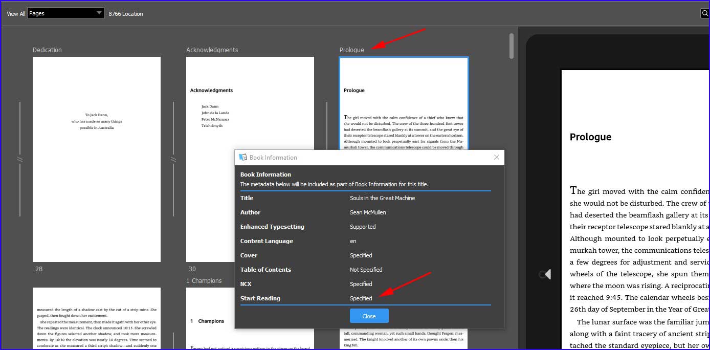

I tried that. It still started at the 6th HTML file in.
When using Kindle Previewer, it works. I guess it is different on actual eink devices.
In the screenshot I used that same code in the Preface file and it is found. I remove that code, and it is shown as "Not Specified"
