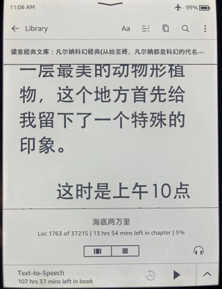

Originally Posted by Devot3d View Post
[IMG]https://www.mobileread.com/forums/attachment.php?attachmentid=195705&stc=1&d=1660044 833[/IMG]
Anyhow, you can see on compatible books there's a headphone icon
[IMG]https://www.mobileread.com/forums/attachment.php?attachmentid=195706&stc=1&d=1660044 833[/IMG]
When you hit the icon and press play it will try to connect to your bluetooth device.
[IMG]https://www.mobileread.com/forums/attachment.php?attachmentid=195707&stc=1&d=1660044 833[/IMG]
While reading it will underline the current sentence.
The TTS actually sounds really good.
[IMG]https://www.mobileread.com/forums/attachment.php?attachmentid=195708&stc=1&d=1660044 833[/IMG]
As you can see the voiceview screen reader is not turned on.

Sorry but I don't see an image in your first post.
That would explain all the confusion in this thread 🤣🤣🤣🤣
I see them but opening the thread in a private browser window I no longer see the images 😅
That would explain all the confusion in this thread ��������
I see them but opening the thread in a private browser window I no longer see the images ��
Here are those images, I think it was my "new user" status causing trouble
1 is the headphonee icon
2 is the play controls
3 is during reading
4 is voiceview not being active.

Yes, it first appeared in firmware version 5.13.1. This is the first report of the feature being active that I know of.
I can't recall exactly when I found it was working, but I've been using it for at least a year, probably at least two.
This is pretty fascinating. IIRC @jhowell found some references to Text to Speech in one of the updates awhile back. Why they would choose to enable it in China, of all places?

Originally Posted by tomsem View Post
Also, @Devot3d, perhaps you could share one of the ASINs so others can try stuff?
I don't mind, This is the one I've been using: B078N42JWX but I suspect it is only whitelisted on my device.
