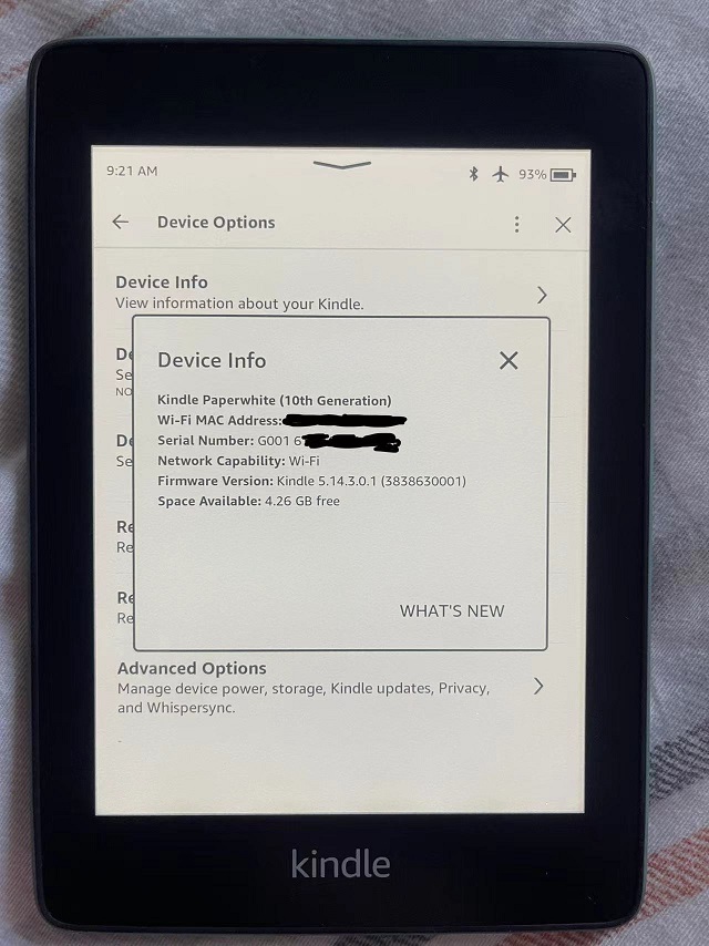

There's a lot of speculation on this thread that is misplaced. Unfortunately even though my account is 12 years old I haven't posted much so I guess moderators have to approve every post.
You can see here that it is literally a bog standard 10th gen Kindle.
It's not running Android, just the normal Kindle OS. It is also actually running text to speech not some sort of mp3 file.
Anyhow, some things that I've discovered while my posts were waiting for moderation: I did a lot of experimenting with different files and formats and messing with different metadata.
What I found is that I could use Calibre to take the ASIN from a book that has working TTS and transfer that to any book (as long as the book's language is set to Chinese) and convert to the KFX format and the TTS would work.
It didn't matter if there are multiple books using that ASIN. But as soon as you alter that ASIN the Kindle no longer allows TTS on that book.
My theory is that the Kindle is storing a database of ASINs for books you have purchased (and allow TTS, Harry Potter didn't when I got it on Kindle Unlimited) and using that to determine if TTS is allowed.
I could be mistaken about how they are doing it, but that seems to fit with what I've found.

No, you are mistaken. If you look at my first post you will see the picture showing that voice view is turned off. I tried voice view once and it was an awful experience.
This tts is a nice experience, it has a sleep timer, speed from 0.5x-3x… and it’s not some secret Audible file masquerading as tts.
I don’t think Amazon even bothers trying to run an Audible branch in China.
This is standalone TTS on a kindle pw4 and it only works on books in the KFX format and with ASINs of books I have purchased. It’s not some other thing that works on any old book you download from the internet, if it was I would have never bothered asking the question.
Devot3d is offline   Reply With Quote
