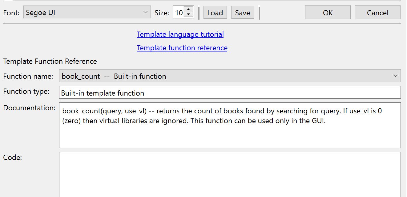

It is there for me. To see it you must be running calibre 6.0 or newer.
thats it .... I still wait a bit till I will update to 6.
I did not expect that booko_count is a new one.
