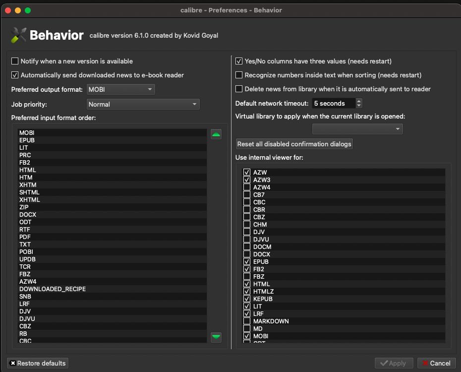

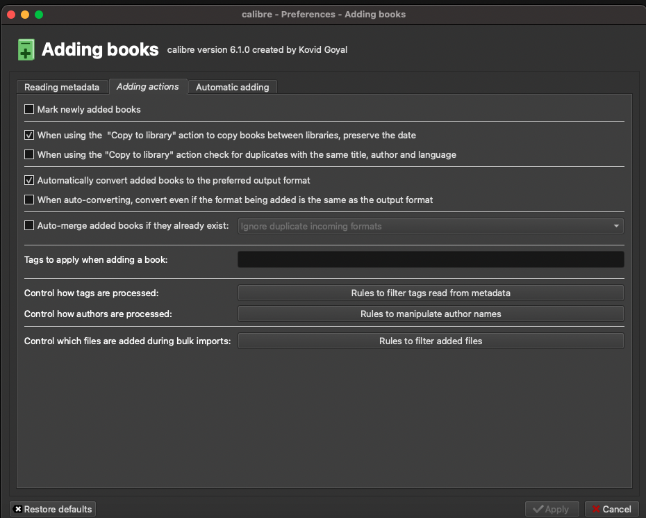

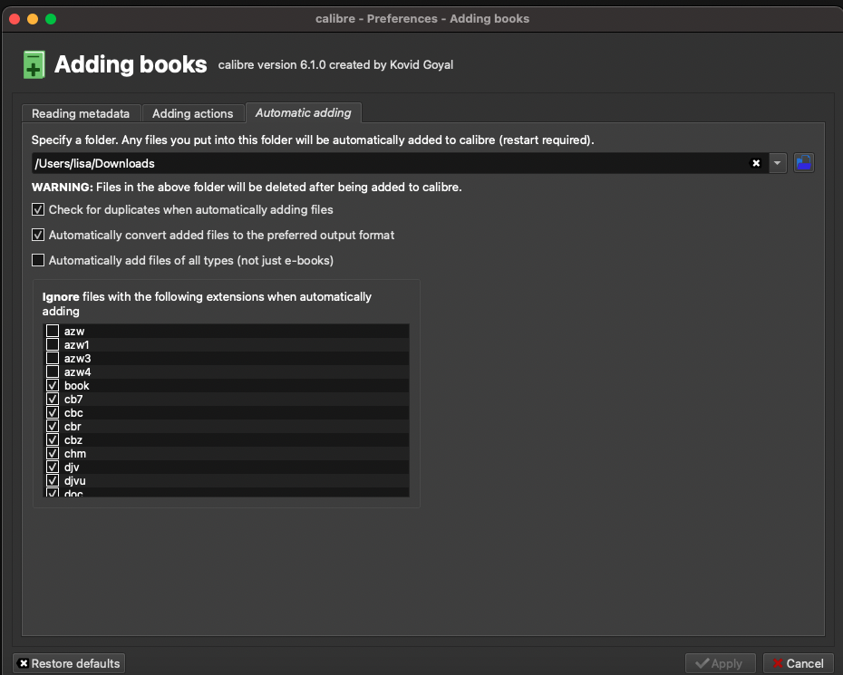

Obviously, I can re-create this consistently, so... to do a clean test I created a new Calibre Library. Then restarted Calibre.

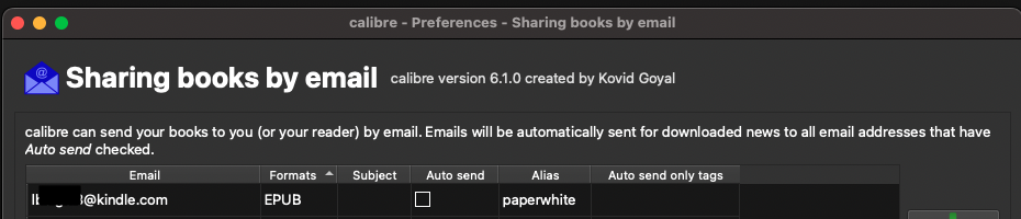

Checked the settings (images attached).
Then I went to Amazon, "Manage your content and devices", and chose "download & transfer via USB" on a book I have purchased.

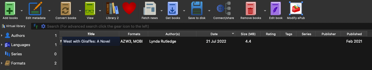

The book was downloaded to my Downloads folder, so it was auto-added to Calibre & converted to MOBI instantly. (image is attached)

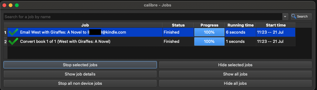

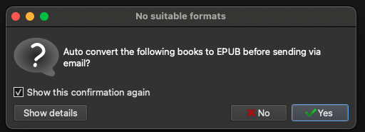

Then I chose Connect/Share, Email to..., and chose the Paperwhite alias. Received the "autoconvert to EPUB question" (image attached). Answered yes and email was sent. (job image is attached).

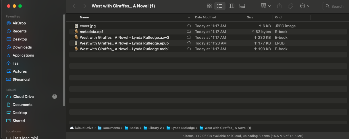

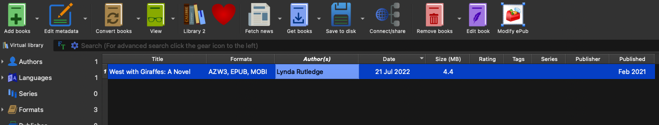

Next images show that the EPUB was created and that they do exist in my file system.

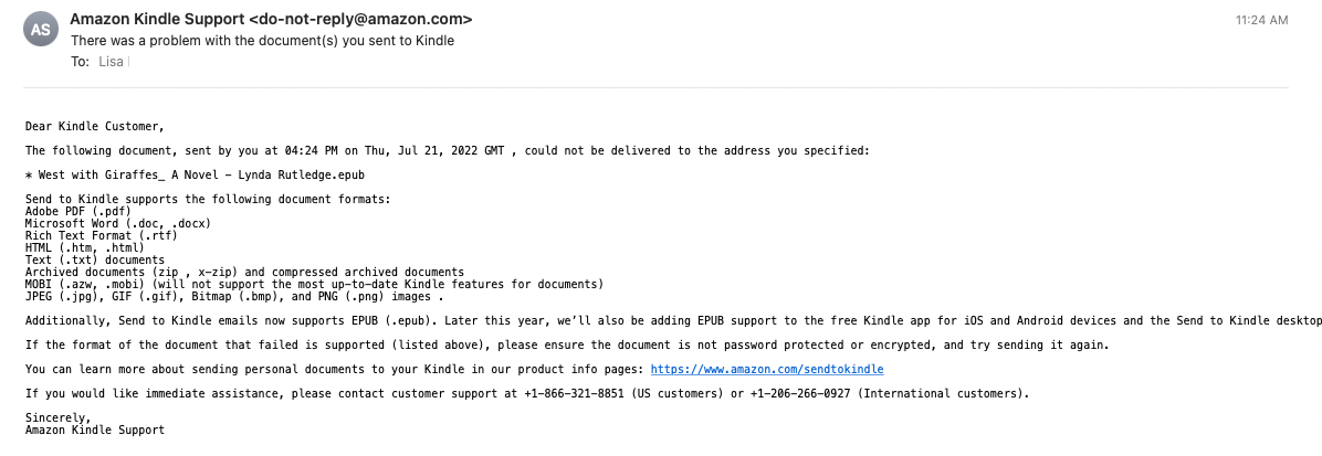

Also attached is an image of the email from Amazon saying it failed.

I'm running:
Mac Mini M1 Monterey v12.3.1
Calibre 6.1
deDRM 10.0.3
(however this was all happening with calibre 5.14 and deDRM 7.1.0 - I upgraded yesterday in case that was the problem)
Here is an additional link to the images in case its easier to view them on Imgur: https://imgur.com/a/W2bYUFY

Grabbed a purchased book from Amazon, saved it to downloads folder, Calibre auto added/converted. (images 1 & 2)
Then I emailed it to my Kindle. (image 3)
Proof it was converted and emailed. (images 4, 5, 6)
Amazon's failure email. (image 7)

That being said, in looking at the settings in Preferences>Conversion>Common Options>Page Setup, I had my "input profile" set to "kindle". I tried changing that to "mobipocket books", restarted Calibre, and then tried the whole process on a newly added book again, but no luck. EPUB was still rejected by Amazon. And when I go into the Convert Individually dialogue, the input format still defaults to AZW3.
I'm also not sure why you suggested "Restore Defaults", but that doesn't change anything. I think AZW3 is the "default" input format, even though I have MOBI above AZW3 in Preferences>Behavior>Preferred input format order.

5. I right-click Connect/Share>Email to my kindle. Calibre asks to convert to EPUB, I click YES.
6. EPUB is created and emailed.
