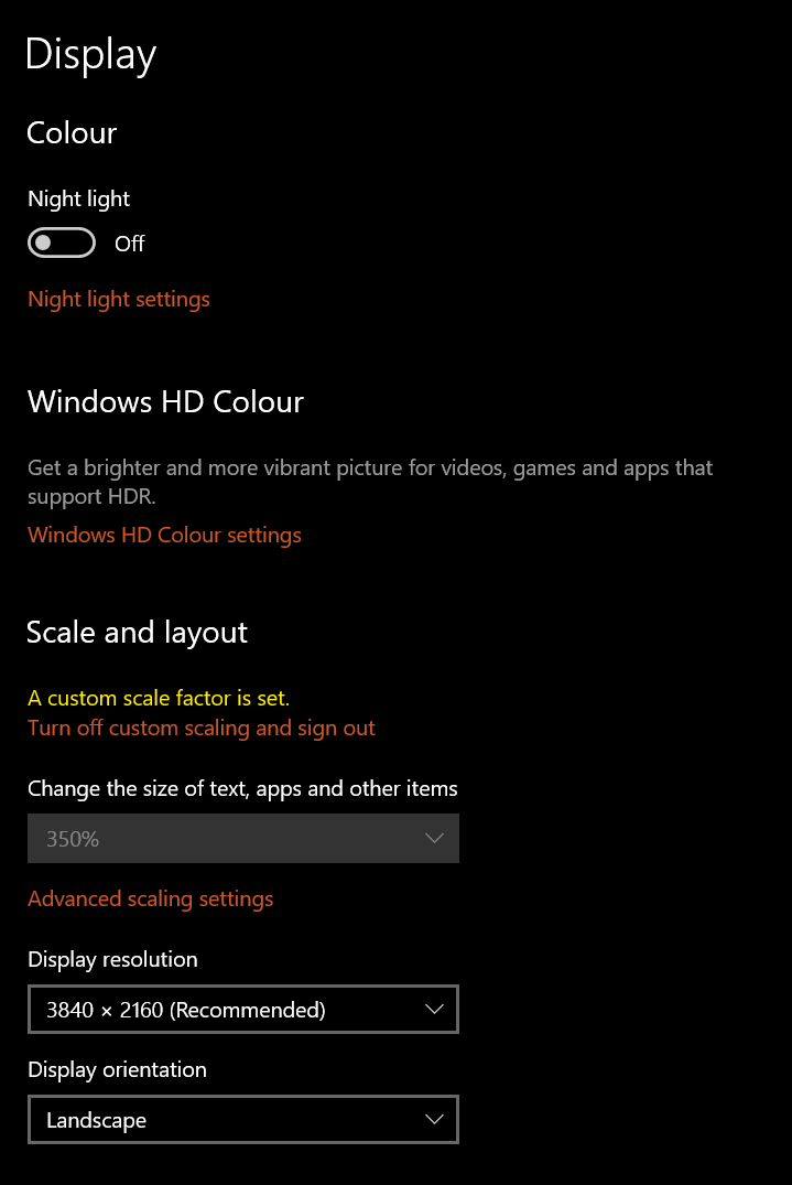

Perhaps Uncle Robin and Sirtel could disclose their display scaling setting, that might go some way to disproving my fractional scaling theory.
I was stunned to find that my display scaling settings are as follows, I thought it was at 125%!
