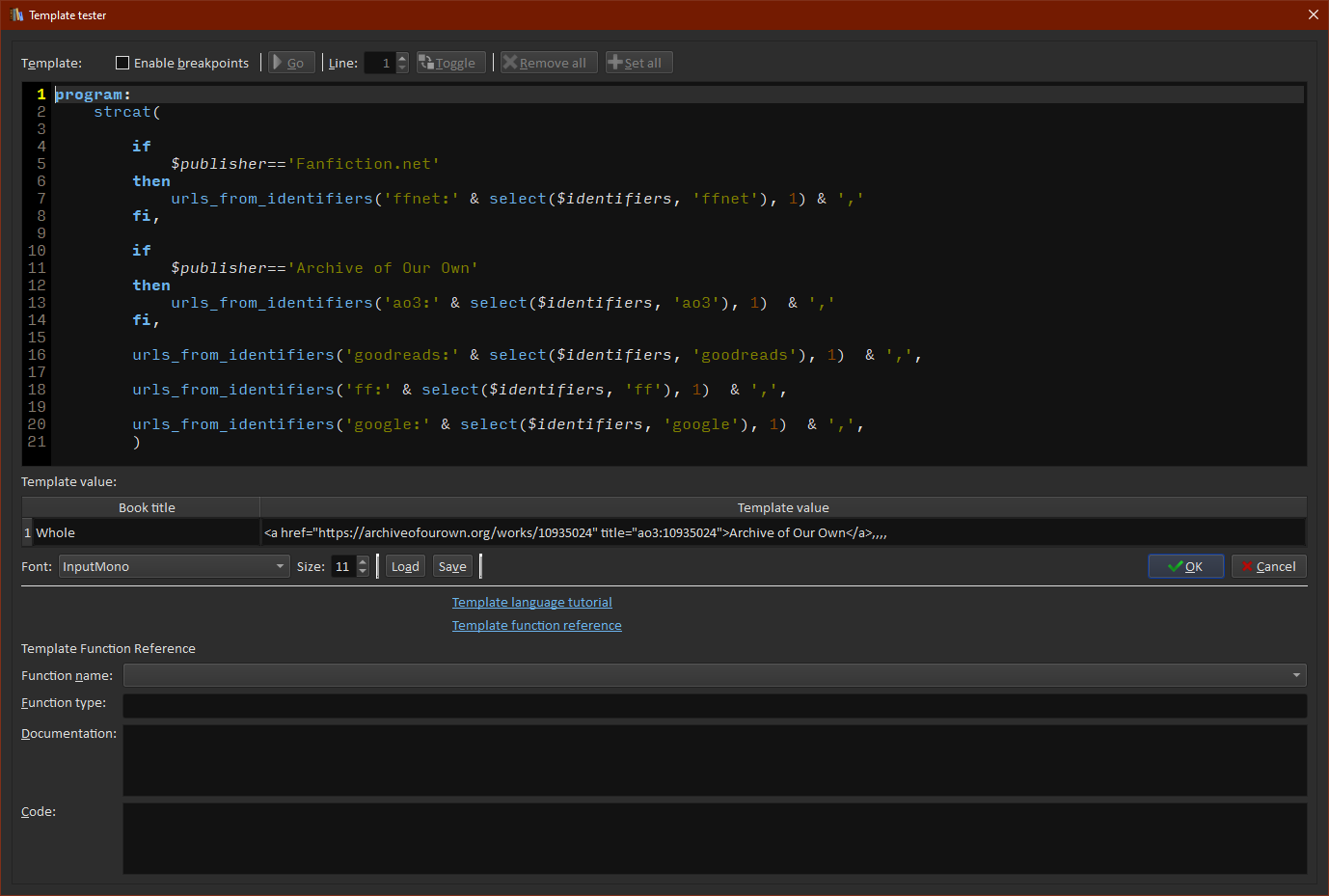

strcat: What would be the best way to add the comma separators here? I thought of "if id then output" but that seems clumsy.
Name:	2022-05-26 15_48_01-Template tester.png
You can do it with list_join. I don't have your actual text and don't want to read/type it in, but it would look something like
program:
list_join(
    if x then urls_from_identifiers('foo:bar', 0) fi, ',',
    if y then urls_from_identifiers('mumble:fratz', 0) fi, ',')
The list_join function ignores empty lists.

list_join works, though I had to set the separator to ', ', (with an additional whitespace character); unsure if that's intended behaviour so I'm noting it.
You need to do that only if you want to see a space after the comma. The space isn't needed for anything except its appearance.

I just noticed that without the additional space it lumped together like 'Goodreads,Fantastic Fiction,Google."
