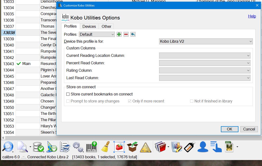

Old 07-12-2022, 01:05 PM   #2515
Posts: 32,012
Karma: 65700000
Might be a corrupt config file. As you can see, it works here.
Question: Was the PI current BEFORE the upgrade to Calibre 6?
