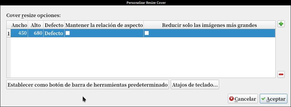

Spanish translation
Hello people, here I leave the plugin with the Spanish translation
ID:	183747   Click image for larger version
