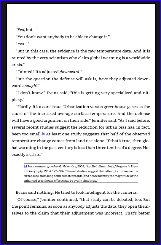

I tend to add my footnotes in the flow of the text, usually directly after the paragraph that requires the footnote. I know, I'll probably be laughed off the forum for doing it this way, but it works for me, and I don't need to be jumping around my novel trying to read references. Plus, general fiction novels that require footnotes are an exception, rather than normal, and there aren't many of them.
But no reason you couldn't place the footnotes elsewhere using the same code.
For the example in the image, this is how I code it...

On paper, you would just glance down at the bottom of the page. So sticking it below the paragraph in an epub worked pretty much the same. Next one I run into, I'll try coding it it your way. No laughter at all.
Thanks @retiredbiker
Sometimes trying to click on those tiny links with my sausage fingers causes me to call up the dictionary, highlighting, context menu... everything but the footnote, then when I eventually jump to the footnote, I realise it was nothing worth reading and have lost the flow of reading.
Having it right there as shown in the image, I can quickly glance/read the footnote without fuss and then continue reading without lifting a finger And it does in a small way replicate the pbook treatment of having the footnote at the bottom of the current page.
My CSS if it helps anybody...

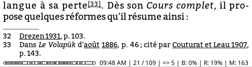

But how the footnotes are displayed? It's all device-/app-dependent:
  • On some devices, the popup may only show the 1st paragraph, you may have to click to jump to read the rest.
  • Others use heuristics to guess when footnote 1 ends and 2 begins.
    • Kindles
  • Others display footnotes in a "footer". (Similar to a printed book.)
    • KOReader
If I remember correctly, to detect popup footnotes, Calibre's Viewer looks for at least one of these:

Originally Posted by DaveLessnau View Post
In terms of what was discussed here (on_page footnotes in a pop-up), it looks like I've got things working with <aside> (epub3 only).
Ahh, I was in the middle of typing my entire behemoth before you posted this.
The problem is that the <aside> text is visible in the chapter. As noted before, for one or two short footnotes in a book, that's fine. But, this book has 58 chapters full of "footnote" material.
I can't find a way to hide that <aside> text (I tried "hidden" in various places in the code, but it didn't work). Does anyone know of a way to hide that? If not, I'll work on the <aside> material remaining in its own chapters.
Give it up.
It's not smart trying to hide footnotes via CSS like:
display: none;
or:
visibility: hidden;
This will cause lots of other bugs/headaches for you. See:
Side Note: A few weeks back, I did run across a DAISY webinar recommending to mark an endnotes file with linear="no", but that has issues as well:
See that topic for just one example.
Hint: Not much has changed since 2016.
There are a tiny bit more apps that support linear="no", like Thorium, but it's still a mess and will cause more problems than it "solves".
It would be "better" than messing with display/visibility though...
So this is how I would rank them:
  • My recommendation: Don't mess with display of footnotes/endnotes.
  • Moderate/Strong against: endnotes file with linear="no"
  • DO NOT ATTEMPT AT ALL: display: none; or visibility: hidden;
EDIT 1: One site I found said the epub:type="footnote" bit should automatically hide the <aside> stuff. But, it doesn't. Another site said the "hidden" attribute can be used to hide it (i.e., <aside hidden ...), but it also doesn't.
EDIT 2: it looks like I tried testing the hidden attribute with a class= style applied. The class= overrode hidden. I'll play around with it some more.
Give it up. Trying to do this may "fix" it in some apps but completely break it in others.
This may only be possible if you are targeting a very specific app in a very specific app store. (Or if you are creating this ebook only for personal usage.)
If you're trying to put this EPUB up for sale across the actual stores, this won't work across devices/apps.
Side Note: And again, I will reiterate what I said in 2013...
What's the big deal of footnotes sitting at the end-of-chapter/bottom-of-files?
How the heck do you read physical books? Do you see the footnotes at the bottom of the page and fling the book out the window?
No, you just skim your eyes right over (or turn the page), or jump to the next chapter, and move on.
