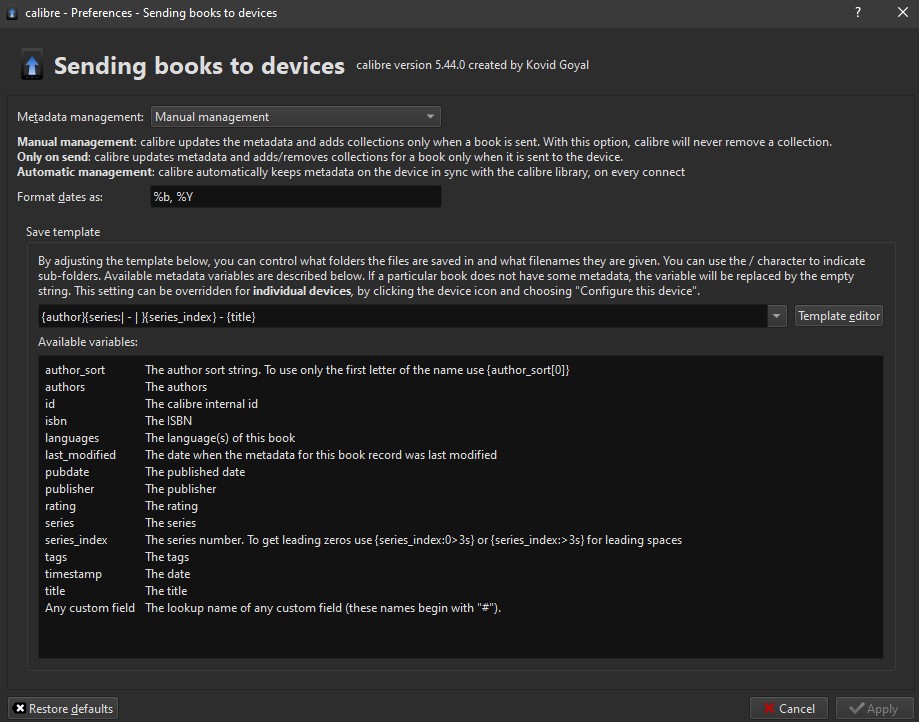

After some more testing I just found no way to save the filenames in the way I want through calibre. The template option on calibre seems to only work when saving to disk, and according to the internet when using usb connection, but you can't do usb connection on a kindle with koreader. When sending books to device it seems to follow the same format not matter the template, I don't know if this is a problem with koreader, calibre or with what I'm doing.
If anyone knows the solution to this problem please share, thanks.

Are you sure you're using the "send to device" template, and not the "save to disk" template?
Old 07-02-2022, 04:23 AM   #10

Preferences → Sending books to devices → Save template
(Distinct from Preferences → Saving books to disk → Save template)
Yes, I'm 100% sure of that. I used save to disk to test my templates to see if the filenames were how I wanted, then I copied the template to the send to device option.
I'm aware, I added a screenshot of the window on my device to show I'm using the right one, I don't think there's any syntax error since the same template works on save to disk.

Assuming you *are* actually using "Send to Device", that should take. I don't recall if those might not be device-specific, and it's been ages since I've used the Kindle driver, so, do check its settings with the right device connected, too.
(Note that this obviously only applies to newly sent books).
In any case, definitely a calibre setup issue .
I decided to download koreader on my android tablet to test this out, and the results are the same there, the format is always Book title - Author(some number) even on that device.
I have to note that I'm using "wireless device communication" option, which gives me the "Send to Device" button when it's connected. I think this is the only way to connect to calibre that lets you search by metadata, but if there's another option for me to try please let me know.
Could you elaborate on what settings I need to look at? I can't figure out what I'm doing wrong.

I decided to record a video to show the behavior exactly. Sorry for the low quality and shaky camera, I just used my crappy smartphone.
The template I used in the video is:
{author}{series:| - | }{series_index} - {title}
As you can see the resulting filename is not in line with the template, I even tried just making the template the word "test" with no fields so all the books would have the same name but the result is always the same:
Book name - Author(some number)

Aha! That's the bit of info we were missing: the smart device driver is a special snowflake .
xref: https://github.com/koreader/koreader/issues/9284
