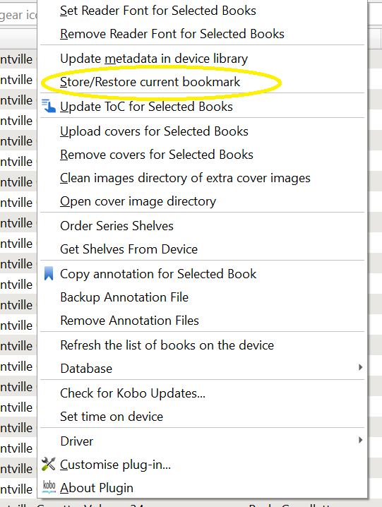

You need to run the "Store/Restore current bookmark" function of the plugin to do this.
sorry but i can't find this option:
mortimer7 is offline
Old 06-30-2022, 03:21 AM   #2502
Posts: 54,219
Karma: 182161593
What version of calibre and Kobo Utilities are you using? I seem to remember using the Store/restore current bookmark option a decade ago
The image below is from Kobo Utilities v2.16.3 and the Store/Restore current bookmark option is highlighted:
DNSB is offline
Old 06-30-2022, 03:46 AM   #2503
mortimer7
mortimer7 has learned how to read e-booksmortimer7 has learned how to read e-booksmortimer7 has learned how to read e-booksmortimer7 has learned how to read e-booksmortimer7 has learned how to read e-booksmortimer7 has learned how to read e-booksmortimer7 has learned how to read e-books
Posts: 70
Karma: 798
Join Date: Apr 2012
Device: iLiad, Kobo Aura 6"
calibre 5.44, Kobo Utilities 2.16.3
Old 06-30-2022, 03:49 AM   #2504
Posts: 54,219
Karma: 182161593
Lost in translation to Italian?
DNSB is offline
Old 06-30-2022, 03:57 AM   #2505
davidfor
Posts: 24,905
Karma: 47303826
Location: Sydney, Australia
You need to start this function from the library, not the device list. Exactly what functions are available depends on whether you are looking at the library or the device.
davidfor is offline
