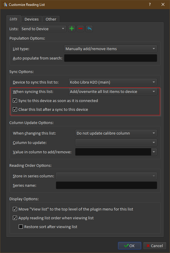

Originally Posted by ciberoba View Post
Any time I start Calibre with the device connected, a task is started that uploads all (120+) books again to the device. This seems to be triggered from the Kobo Utilities plugin, but I'm not sure if it is, and how to prevent this. It takes ages to finish and it's not necessary.
Is there a way to stop the automatic uploads?
Do you have the Reading List PI installed? (and being used )
Nothing in this plugin uploads any books, let alone automatically. The only way I can think of for that to happen is with the Reading List plugin. You might have a reading list that sync to the device with the wrong options.

Old 06-25-2022, 12:21 PM   #2493
ownedbycats
Custom User Title
ownedbycats's Avatar
Posts: 11,837
Karma: 83109135
Join Date: Oct 2018
Do you use the Reading List plugin? This can happen if you have a reading list set to upload books to device without clearing the list afterwards:
Name:	2022-06-25 13_20_46-Customize Reading List.png

Old 06-25-2022, 02:39 PM   #2494
Posts: 84,659
Karma: 153788055
I use the Reading List plugin to add the eBooks to my Kobo when I connect to my library. It adds only the eBooks I've added to my default list.
