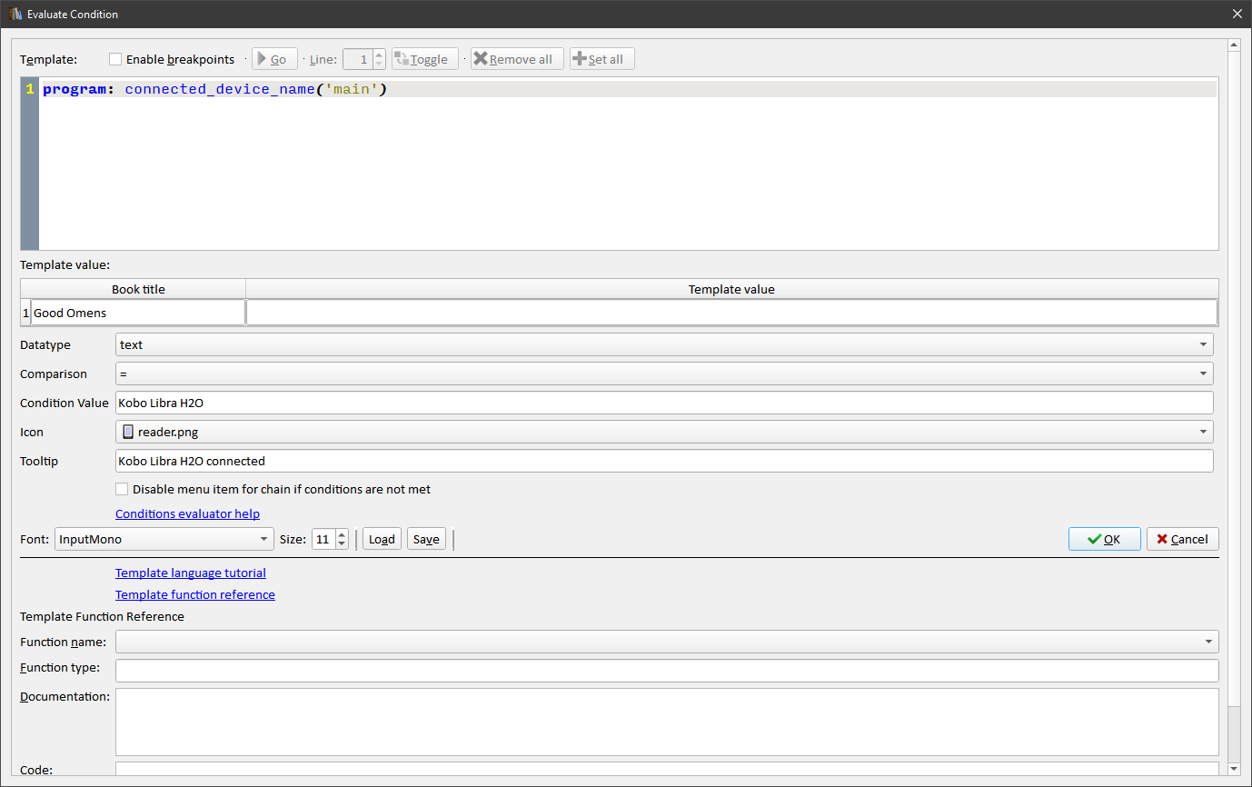

In the Calibre 6 beta, the condition evaluator isn't working, at least for connected_device_name('main').
This screenshot was taken with my Kobo Libra H2O plugged in, and it returns that in the standard template tester.

Old 06-28-2022, 05:26 AM   #872
chaley
Posts: 12,529
Karma: 8125420
Location: Notts, England
If you run the beta from source then get Kovid's latest changes. The fix he made for updating in the template tester will also affect this. Alternatively try his test: check and uncheck the bookmarks box.

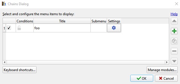

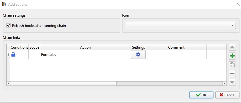

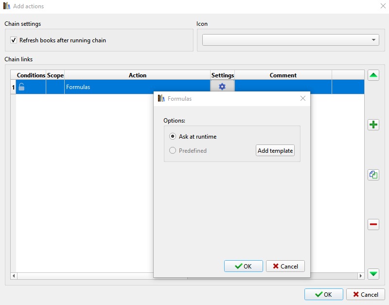

I made this very simple chain (sorry about the images):
The chain:
The chain condition:

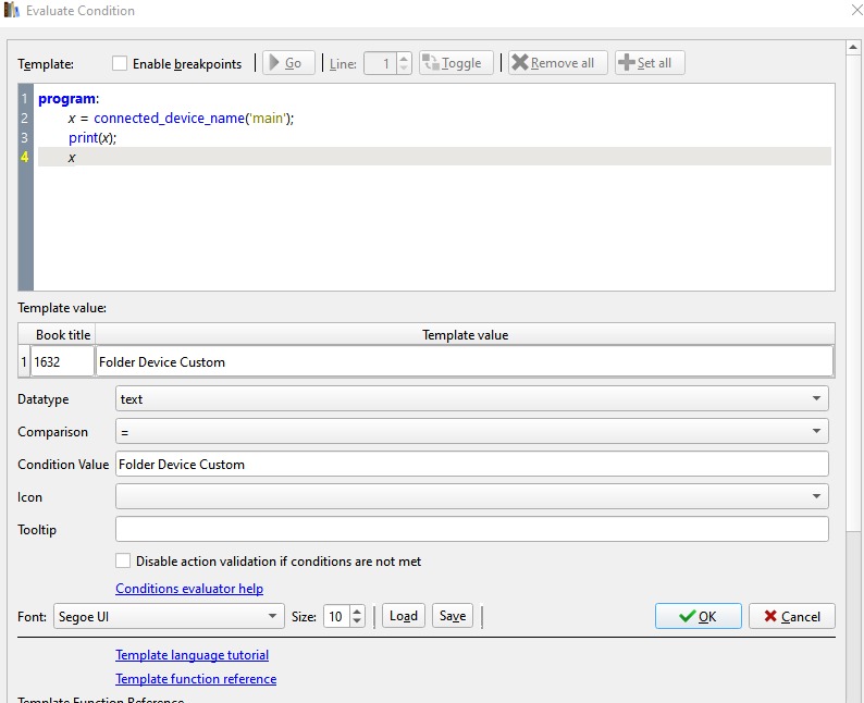

The action:
It works. The condition succeeds when I am connected to the folder device.
It also worked when I put that condition on the action, not the chain.
You might consider putting the x= and the print() into your condition. When running in debug mode you will see what connected_device_name() returns in your case.

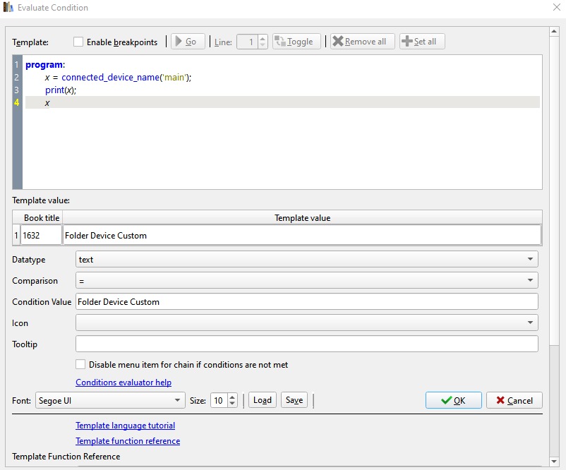

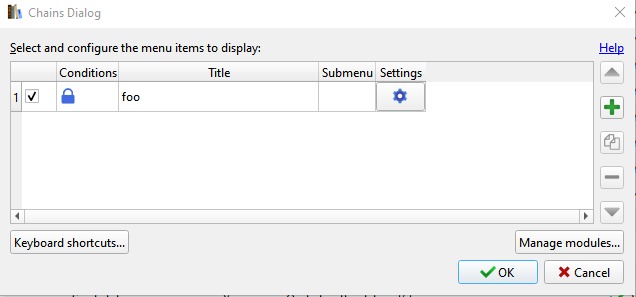

Screen images:
ID:	194632   Click image for larger version
ID:	194633   Click image for larger version

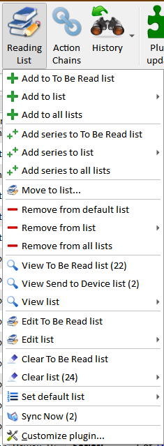

I noticed one thing: with a book on the list, the menu option changed to 'Sync Now (#)', where # is the number of books ready to sync. I'm not sure if that would cause it to break with a conditional (and it worked before in 5.44, so...)

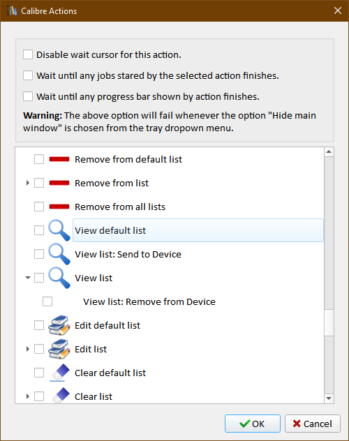

EDIT: Another quick test: I set a simple chain to open the reading list options panel when the Kobo Libra H2O connected. This works as expected.
Then I went to set it to 'View To Be Read List (#)' and... the option wasn't actually available as a Calibre action?
Name:	2022-06-29 13_58_58-Calibre Actions.png
Name:	2022-06-29 13_52_24-.png
Attachment 194655
At this point, I am beyond hunting down every option in every plugin to make it work with Calibre Actions.
