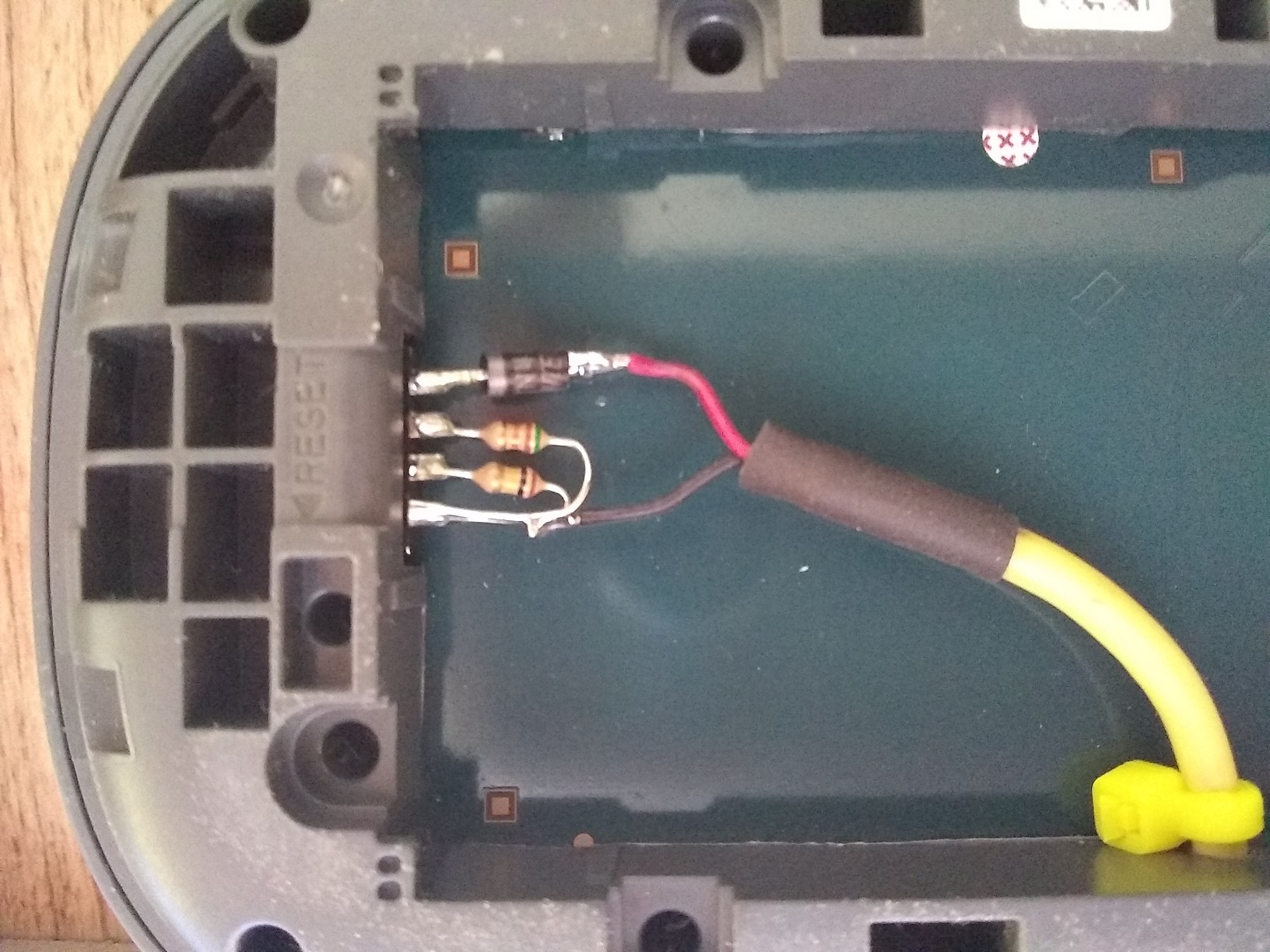

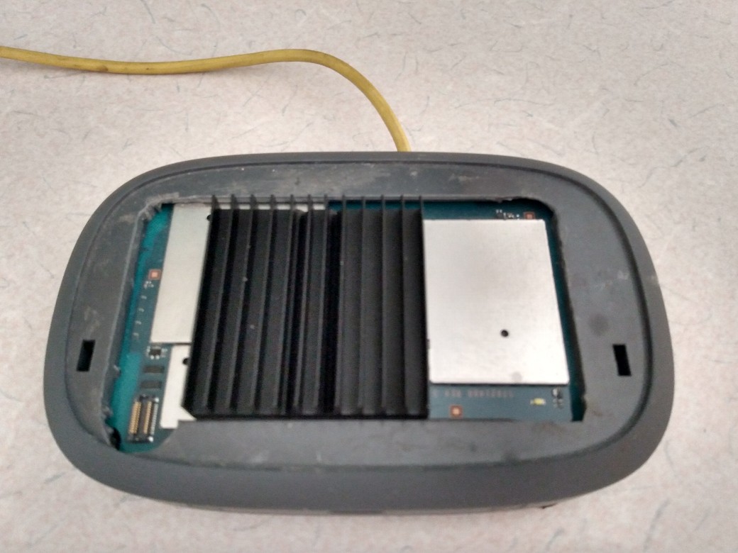

Most devices want to "see" a battery. It can be a thermistor or an ID resistor or I²C to a BMS. I just remove the battery cells themselves and reuse the old BMS (the tiny PCB inside the battery pack). You feed that 4V and it's as happy as a pig in ... stuff. I have a half dozen devices so outfitted. Some I modified straight out of the box. It's safer. Verizon had recalls for flaming hot spots.

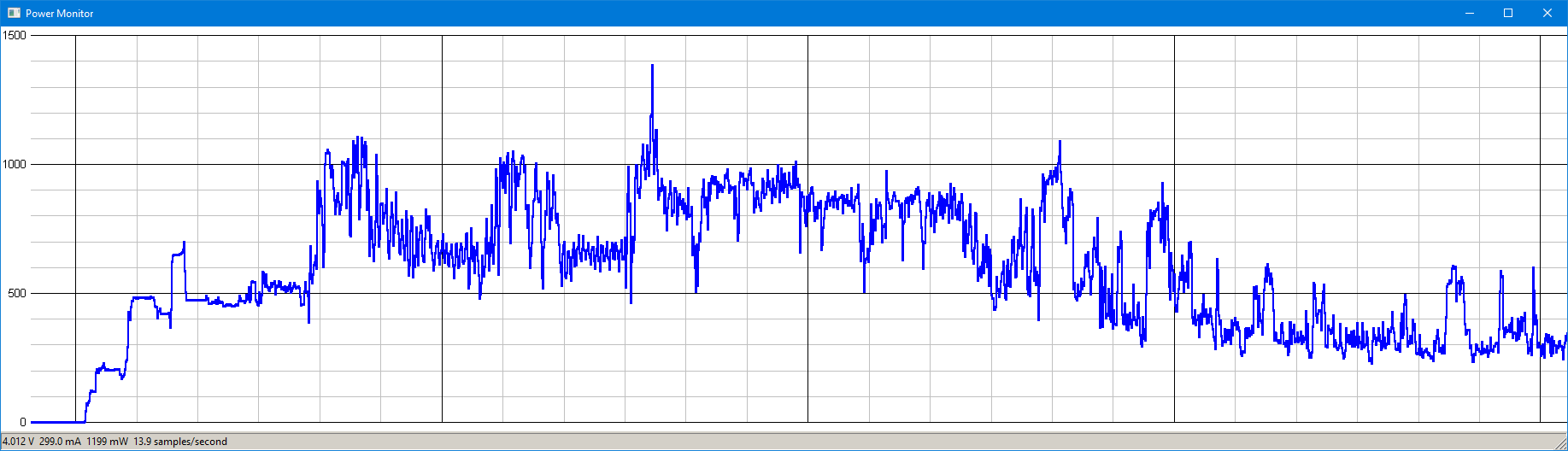

Maybe I've stated that poorly. Every device requires large start-up current that is usually in excess of what the USB can deliver (unless it's a Type C wih PD). In any case, what I meant is you can't just connect a power supply to red and black of where a battery used to go and get the thing to boot (unless it only uses two wires). The 3rd and 4th (if present) have to be connected to something that say, "I'm a battery!" Here's a photo of my Verizon hot spot which I'm using right now. Before it ran hot (which increases noise in the front end, killing performance in marginal areas). I removed the battery, the front window, the display and installed a heatsink. It runs much cooler now.
Here's a plot I did of something (I forget what) but you can see that it peaked at a good 1.4 Amperes when booting! Most devices hit at least 1 Ampere. Edit: I think that's my Nexus 7. I checked my Moto E5 and it hit an Ampere.
That doesn't sound right. If it were, devices powered via USB only (with no battery at all) would not be a thing - and yet they are ubiquitous, including devices with a high startup current.
I think we're on the same page now :-). I did initially think you were saying that you could chuck something there that *appeared* to be a battery, but delivered no useful power. The Poke 2 is the only device I have ever encountered that *requires* battery power (i.e. useful current, not just battery presence) to at least partially boot before it can start to utilise power from the USB port.
Most USB chargers supply at least 1A, and modern ones a lot more than that.
If you were trying to run the thing from a 500ma computer port, I could see your point... but that isn't a realistic limitation when we're talking about chargers.
