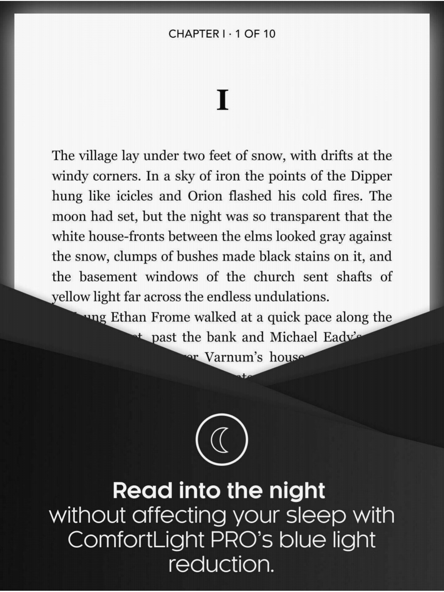

Out of curiosity and ignorance, what are these demo slides?
xyclonei is offline   Reply With Quote
Old 06-09-2022, 09:41 PM   #17
Posts: 54,672
Karma: 182340541
What you see when you put the device into demonstration mode. Type demomodeon in the search box. If the images can't be found, you will get a popup saying Demo slideshow not found.
Edit: Attached a sample image of the demo slideshow
