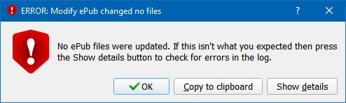

Originally Posted by DaveLessnau View Post
In my case, the test_4 version failed. It looks like it worked regarding the ToC, but overall it came back saying it failed:
It seems that there is no error, but that when mod-epub don't find anything to correct, it emits this msg (in action.py). Do you confirm, Chaley ?
Yes. The problem is that it could have failed or it could have done no work. At this point it doesn't know which.
I am changing the wording of that message box a bit to make that (I hope) a bit clearer.

This is the new wording.
