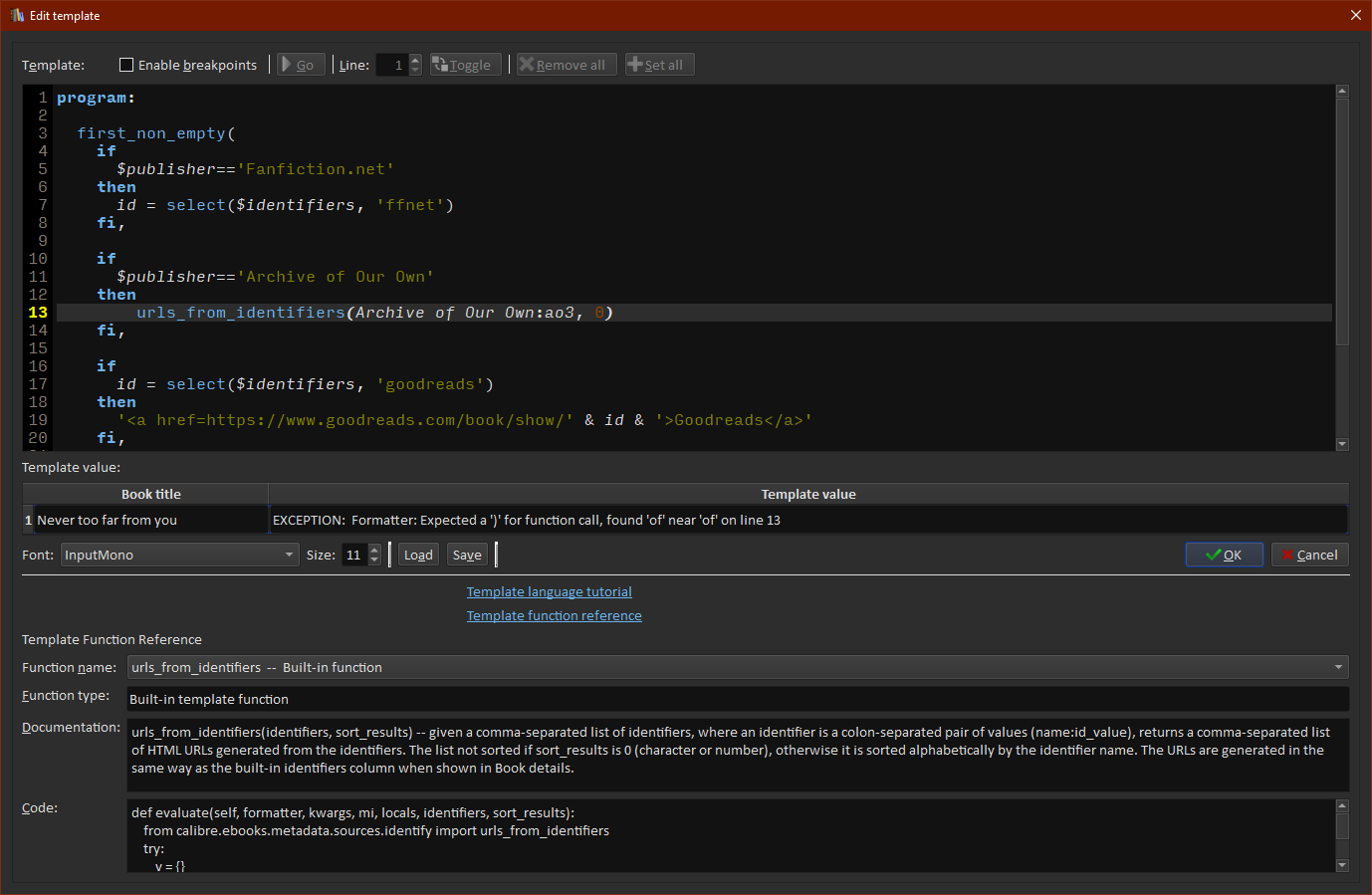

Did I misunderstand the syntax here?
Name:	2022-05-26 15_05_00-Edit template.png
ID:	193979   Click image for larger version
Name:	2022-05-26 15_06_33-Edit template.png
Old 05-26-2022, 02:08 PM   #13
chaley
Posts: 12,529
Karma: 8075938
Location: Notts, England
Yes. The list is a string. The trailing quote goes after the value, as in 'google:12345', not 'google':12345. EDIT: Also, the first value is the identifier key, not its display name. Look at the contents of the identifier field to get the values.
