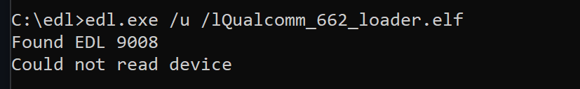

Anyways on to @Renate's edl.exe. At first I kept getting:
Found EDL 9008
Could not read device
I tried 3 different loaders (665, 662, 662 patched).
That was with Zadig driver which is my normal method (screenshot below). Now, I don't know if it's just because I've messed about with UsbDk as well and that was causing me issues with drivers OR it was because I'm an idiot and used the wrong loader (though I don't think so I treid all 3 multiple times with /u and without /u) or if it was because I went into UsbDk (It's in Program Files>UsbDk Runtime Library yeah, the instructions on bkerler are not at all clear why this exists and how to do the thing) and opened a new command prompt inside that folder and ran "UsbDkController -n" and got this:

Did nothing to help bkerler's edl but it did get Renate's edl.exe running! So, I thought I'd post that just in case it's helpful, like if you have that tool on your Windows 10 device trying to get bkerler to work and you can't get Renate's tool to work with Zadig and are getting a similar error, this might be why. I could have been dumb on the loader but I don't think so because I screenshotted the correct working loader error (screenshot attached) so I think it was something else that fixed it and possibly UsbDk. Just throwing it out there.
It works with the 662 patched loader here (thanks @downeaster59!!!!) I ended up renaming it for ease of use below:
C:\edl>edl.exe /l662patched.elf
Found EDL 9008
Serial: f53feefb
HWID: 0014d0e100000000, QC: 0014d0e1, OEM: 0000, Model: 0000
Hash: d40eee56f3194665-574109a39267724a-e7944134cd53cb76-7e293d3c40497955
Sending 662patched.elf 100% Ok
Waiting for Firehose... Ok

@Renate I'll PM you my two recovery images and boot images once I get them all uploaded I got this off of 3.2.2 (which I upgraded to because I'm an IDIOT and wasn't thinking and I should have probably tried from out of the box nvm). The boots are 16MB each, the recoveries are 23MB each. I'm concerned that they're so small because @Cascade94's supplied ones are much bigger in size. Is it because I truncated with the /t? (Update: never mind it's /t truncation. Fullsize is the same size as @Cascade94).
Also I did get some errors doing the pulls just as I did with call for partition table which you might want to look at:
C:\edl>edl.exe /u /r /precovery_a reca.img /t
Found EDL 9008
Configuring... Ok
Requesting GPT 0 header... Ok, receiving... Ok, requesting entries... Ok, receiving... Ok
Requesting GPT 1 header... Ok, receiving... Ok, requesting entries... Ok, receiving... Ok
Requesting GPT 2 header... Ok, receiving... Ok, requesting entries... Ok, receiving... Ok
Requesting GPT 3 header... Ok, receiving... Ok, requesting entries... Ok, receiving... Ok
Requesting GPT 4 header... Ok, receiving... Ok, requesting entries... Ok, receiving... Ok
Requesting GPT 5 header... Ok, receiving... Ok, requesting entries... Ok, receiving... Ok
Requesting GPT 6 header...
<log value="ERROR: Failed to open the UFS Device slot 0 partition 6" />
<log value="ERROR: Failed to open the device:3 slot:0 partition:6 error:0" />
<log value="ERROR: OPEN handle NULL and no error, weird 203949180" />
<log value="ERROR: Failed to open device, type:UFS, slot:0, lun:6 error:3" />
Nope

The "ERROR"s on GPT 6 is just because there isn't a GPT 6.
I've been just enumerating GPTs until I get an error then I know how many there are.
The new bit with the "Querying info" will tell me that so I don't have to search blindly.
In any case, it's an anticipated error.
I don't own any Qualcomm things with UFS which is why I have to ask you so that I can plug the responses into my EDL server emulator so that I can work on/test my EDL client.
One reason things get so tricky with this Qualcomm stuff is that with Sahara the device is supposed to speak first and with Firehose the host is supposed to speak first.
Normally you know whether you have loaded the loader already so there's not much confusion.
I could try to make it try to find its way through, but I've learned that there is so much flakiness in all this EDL stuff that it might only work for some chips and not others.
When you do an "edl /z" it should disconnect immediately. For a normal reboot on an unlocked device there is a built-in 30 second delay before it boots anything after that.
If you still get no response that's probably because the image that it is booting to is broken.
Since I have the reed switch on my EDL test points I can do this all day long (with the switch activated):
C:\>edl.exe /lpoke3 /z
It takes about 4 seconds a complete cycle.

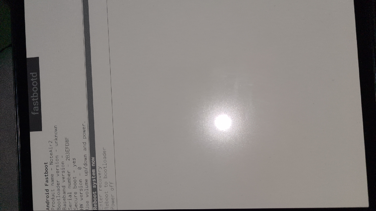

Changing the file extension of edl to.py was a start! I'm still a bit overwhelmed and not getting it working. Anyway I'm still much happier using Renate's edl.exe
I do need help to test boot my patched boot image and then to flash it.
If I follow Cascade94's post:
adb reboot fastboot
fastboot devices (yes it returns my device fine)
fastboot reboot bootloader
fastboot boot mypatched.img
I get the dreaded <waiting for any device> message and it just hangs and nothing happens. Now, if it just takes forever please let me know but I waited a good while on three attempts and that's not usually how that goes with booting/flashing. I tried using Cascade's image and my own patched image.
I tried the method that I use on my Boox Leaf:
adb reboot fastboot
fastboot devices (yes returns device)
I get:
Sending 'boot.img' (98304 KB)                      OKAY [  0.384s]
Booting                                            FAILED (remote: 'Unrecognized command boot')
fastboot: error: Command failed
I assume is something to do with having boot_a and boot_b and not a straight up boot partition?
If I get to adb reboot fastboot alone, I can't actually manually select to get into bootloader (or recovery for that matter) because I have no dang volume buttons to change the selection (do not get me started on this case it is horrible).
Is there another way? I could work out how to flash with Renate's edl.exe tool but the thing that worries me that way is I can't test the boot before flash like I usually do.
If people have suggestions that would be lovely thanks, otherwise Renate, if I have to go with edl.exe best I wait for a recovery just in case yeah?
Thanks all.

No, it looks like there is something wrong with your bootloader command processing.
The "gold standard" is always flashing, then rebooting normally.
OTOH, this is not a good idea if your image is actually bad for some reason.
OTOH, since you know your way around EDL there is not too much risk as long as you don't destroy the partitioning.
As much as I'm a partisan of edl.exe there is not a world of difference between that and edl.py

I'm wondering if it's a 3.2.2 problem, like they're deliberately trying to make it harder to root or something? I'm wondering if I reset back down to factory 3.2 (I think) to see if there's a difference there out of curiosity but I've got it all set up nice now I don't really want to do that if I don't have to also I don't have this issue with my Leaf which is already on 3.2.2.
As it's a new product I just bought, I also wonder if they're cracking down some other way that earlier models don't to make it harder to root?
Could UsbDk or libUSB be interfering?
Edit: Is the secure boot thing a problem?
I'd really rather have a fully working fastboot if I can this makes me anxious (and it bothers me in principle) and I don't really know anything about this otherwise.
bazookajoe is offline   Reply With Quote

I'm confused (normal state for me).
EDL is working ok since you can grab images.
The fastboot that you are showing is the fastbootd of recovery which is not really the same as regular "reboot bootloader".
Are you having some problem?

This is what I tried like Cascade94 said:
adb devices = fine, device is present
adb reboot fastboot = produces that menu picture I uploaded on my screen. I've tried this 10 times at minimum. Same result every time.
fastboot devices = to check if fastboot is working and device read (yes it does)
fastboot reboot bootloader = appears to work get an OK message. Screen turns to ONYX hooray.
<waiting for any device>.
I've also tried going directly to bootloader:
adb devices
adb reboot bootloader
I've tried no bootloader at all:
adb devices
adb reboot fastboot
fastboot devices
That just gives an error because it doesn't recognise "boot" because bootloader and I have boot_a and boot_b blah blah.
I'm not really willing to try fastboot flash boot_a mypatched.img, if I can't even get it to boot to check if the .img works. I just won't. I've always booted up to see if root worked in Magisk before properly flashing/installing. Always.
Maybe there's a special syntax that I'm not understanding because of two boot partitions but still, Cascade94 apparently gets their images to boot to test and see if it works unless things have changed since their last guide.
I understand I could flash through edl but I'd really rather work out fastboot first/understand my device properly.
Edit: and how to boot a patched image first before flashing. That's always been an option available I want to understand how that works on a device with two boot partitions.
