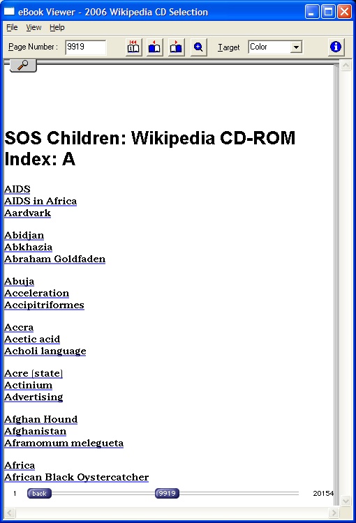

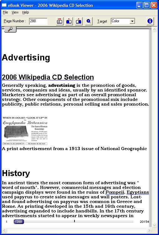

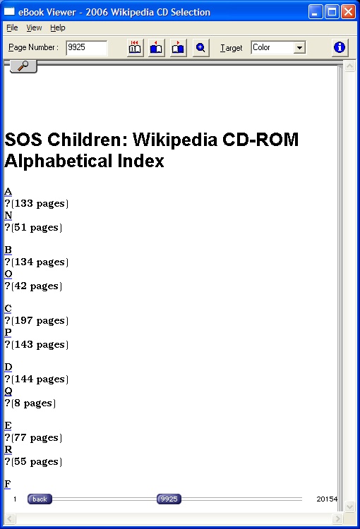

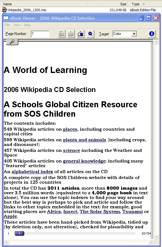

WOW!!!!
It converted on it's first run to my REB1200 .imp format, but the resulting file is TOO huge to be used on my ebook reader. After about 4.5 hours of processing, my conversion software (eBook Publisher) created a 151MB file!
The PC viewer can load it, so I attach some screenshots as the "proof" of concept. Hey, it was fun to even be able to try this.
Now onto round two; decrease the resulting .imp file size by eliminating some or all of the images and/or repetitive text. I would need a 10 fold reduction to make this useable and fear that that may not be feasible. But I WILL try.... — (to boldly go where no man has gone before)

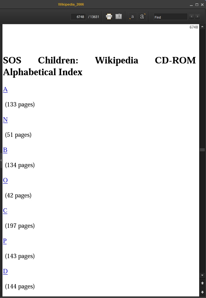

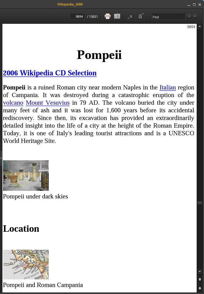

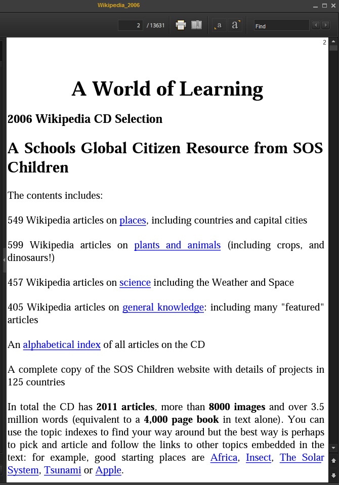

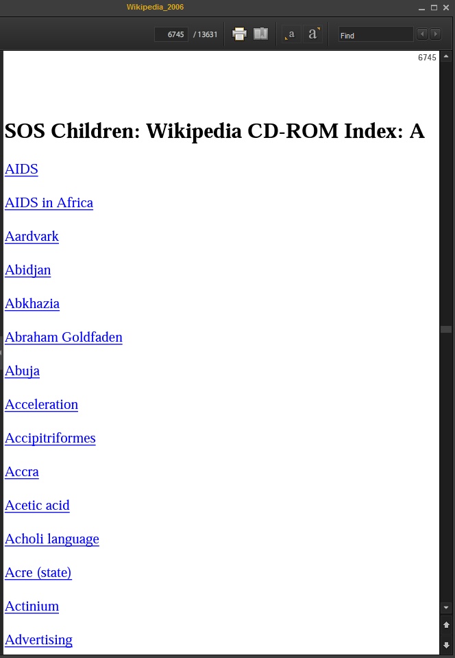

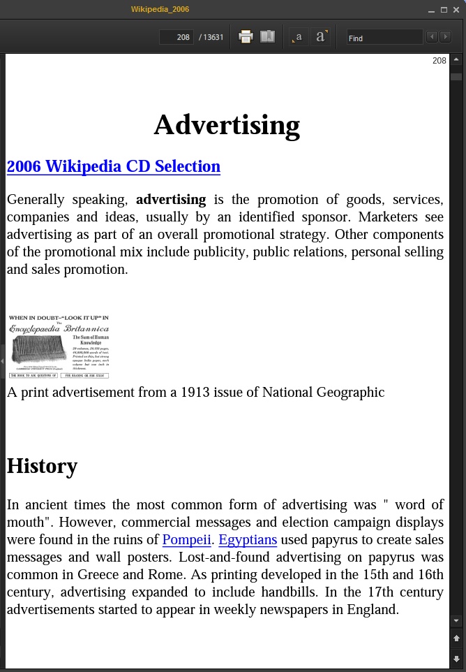

OK, I've completed the round one conversions of this to .mobi/.prc and .epub and the results were similar to my previous conversion to .imp.
Using Mobipocket Creator with standard compression resulted in a 138MB .prc whereas using calibre resulted in a 141MB .epub (see some sample ADE screenshots). In all three conversions, the images seem to be stored in full 16M color resolution (as extracted from explode.exe) and the culprit for the tremendous filesize increase. The (compressed) text occupied only about 10% (12 to 15MB) of the resulting ebooks.
Time to focus on image resolution reduction, but I may ( will! ) not probably get ANY better compression result than Plucker's 43MB .pdb, so this is an exercise in futility, but I don't mind...

Using 4-bit .gif improved the filesize of the final ebook a lot. The .imp now is 50 MB, .epub now 43 MB and .prc (stnd) is 44 MB & .prc (high compression) is 37 MB. There was very little image quality loss reducing from 16M colors to 16 colors.
Still too big to be useful.
If I exclude images, then the resulting filesizes are: 23 MB .imp, 14 MB .epub and 16 MB .prc (stnd).
much more useable...
I'll experiment a bit more and see if using the Wikipedia 2006 CD source directly instead of the plucker extracted .html/images works just as good or better.
Stay tuned...
