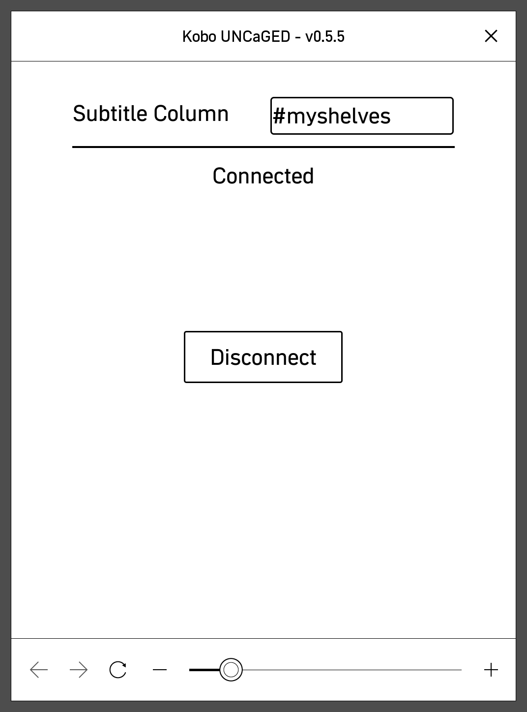

with a blank field (which I can't edit)
This is a dropdown box that gets activated once connected to Calibre. It lists the columns available to use for the subtitle field, and you can select a column.
I implemented it this way so the user didn't have to type the column names in themselves, but it doesn't know the columns ahead of time, hence the delay in activating.

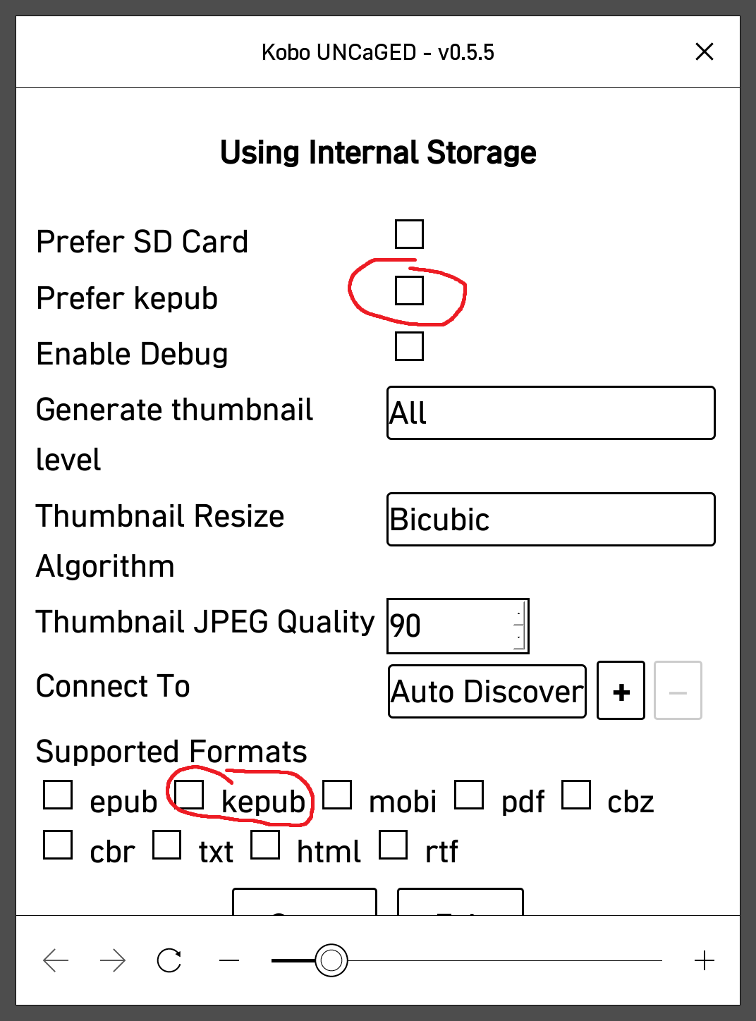

Cant see any book in calibre library.
I installed Kobo-UNCaGED and NickelDBus correctly,and louched UNCaGED,calibre wireless device successful,everything looks good。
But I cant check the option,I cant see any book from the server,where am I doing wrong?
Thanks for help.

You cannot list books from calibre on your Kobo. It works a lot like physically plugging in your Kobo. Once on that connected screen, it will show as a connected device in Calibre. Select the books you want to send in Calibre, and choose 'Send to device'.

THX!I understand.
