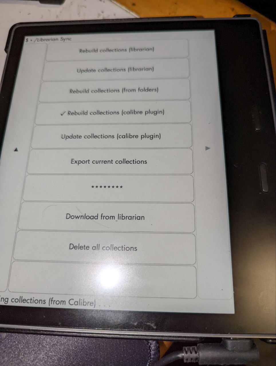

I got the JB done, I am now trying to get Librarian or collections up and running but it gets stuck on the rebuild collections screen.

Neither Librarian nor the Calibre plugin currently support the PW5 (because free time has been harder to come by than I hoped).
Those should be the two major unsupported things right now.
The Easter week-end allowed me to catch up a tiny bit, so I'm *hoping* to get this done sometime in the next month, but don't hold me to that .
EDIT: Oops, you appear to be using a KOA3. That *may* also apply to your device, I honestly can't recall.

I appreciate that, I happened to check the forum and see that there was a JB coming out the next day. One of the main reasons I JB is for collection management.
