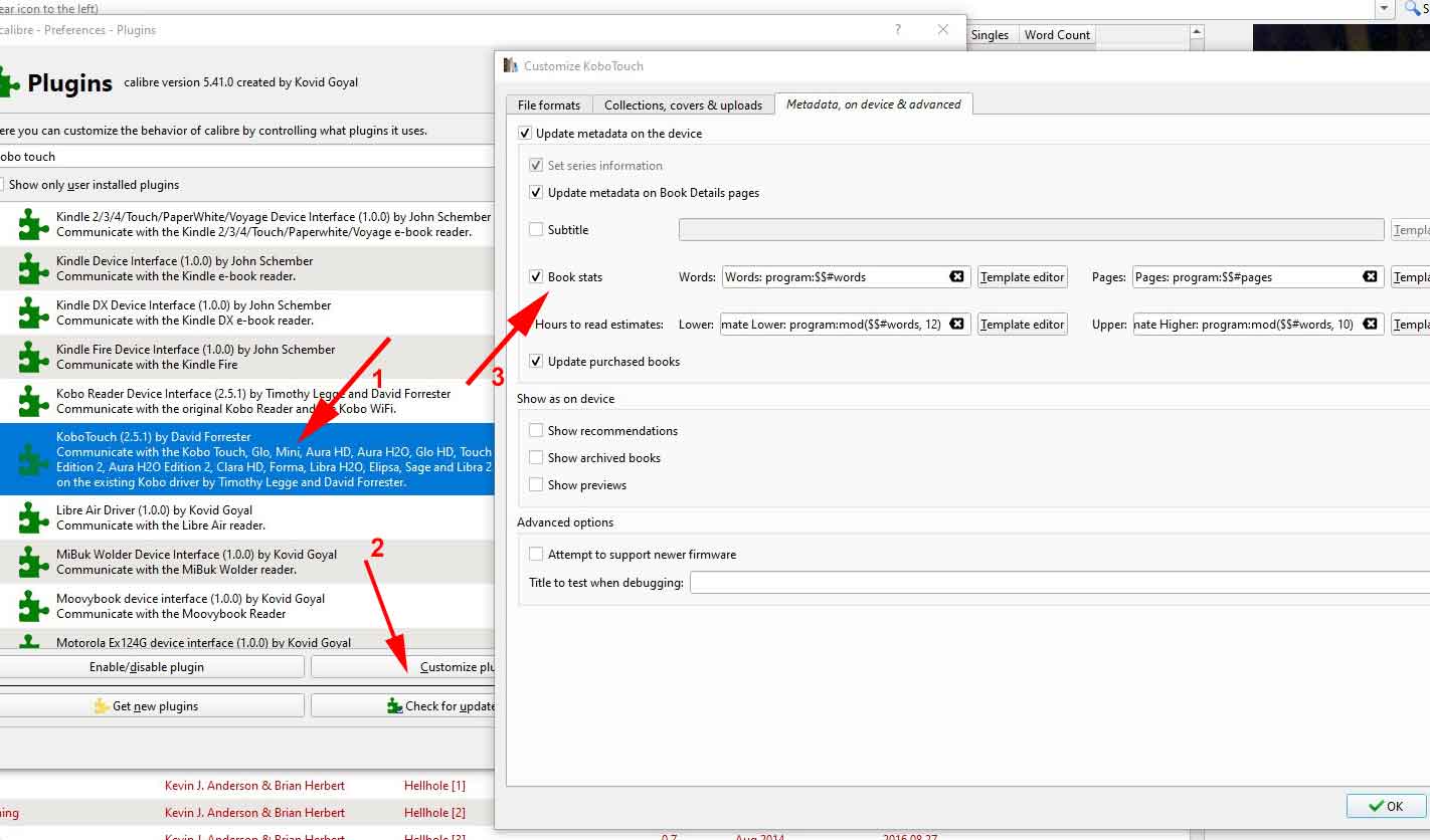

Location: Australia
Originally Posted by Deobulakenyo View Post
Is there a tutorial for non techies for this? Where do we put the template? Do we have to put the manual word count? I really do not get what needs to be done. To be clear i am not blaming anyone other than myself for not understanding this. Just asking others to hold my hand for me to understand this.
Maybe my image below will help...

There is no explicit tutorial for this, and I was pretty explicit with where it went in my first post (highlighted above). There are tutorials, help and lots of discussions about calibre templates. The tutorial and help are available from the template editor which can be used from the configuration.
Thank you. I put the following in the Metada on device and advanced tab of the Kobo Touch extended plugin:
Words: program:$$#words
Pages: program:$$#pages
I left the estimates fileds below them blank.
Clicked okay and apply.
What happens next? Does this automatically calculate the number of pages and words of my sideloaded books on my device when i connect my kobo to calibre? Will my sideloaded books now contain words in View Details of my device?
Deobulakenyo is offline   Reply With Quote
Old 04-23-2022, 04:15 AM   #345
davidfor
Posts: 24,905
Karma: 47303828
Location: Sydney, Australia
The driver will update the metadata on the device when the device is next connected. What is update depends on what has changed in the library. But, as I stated in post immediately under the one you quoted, this will not happen as calibre will need another update.
