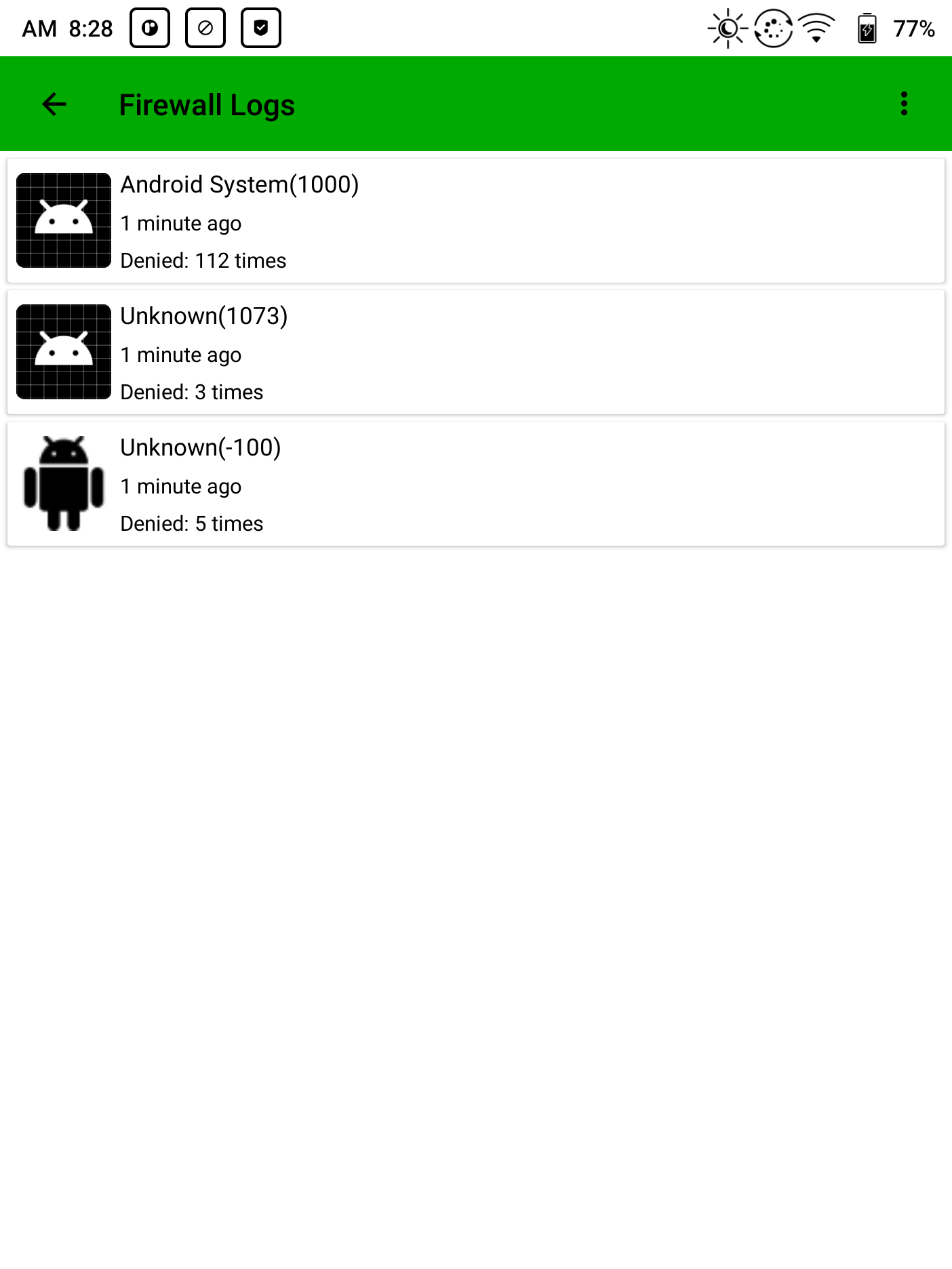

Originally Posted by downeaster59 View Post
I'm curious about AFWall+. I imagine its purpose is to keep our Boox devices from phoning home to China for unknown reasons. Other than trial and error, how can I tell which activities I should block through AFWall and which to permit? Thanks!
For a bit more explanation, here is a screenshot of the AFWall+ Firewall Logs.
Android System(1000) all of the IPs appear to be US and Google related. (port 443)
Unknown(1073) also seem to be primarily Google / US, also Alibaba / US. (port 80 and 443)
Unknown(-100) is all Tencent / China traffic. (ports 8080, 80, 443, 9906 and 14000)
