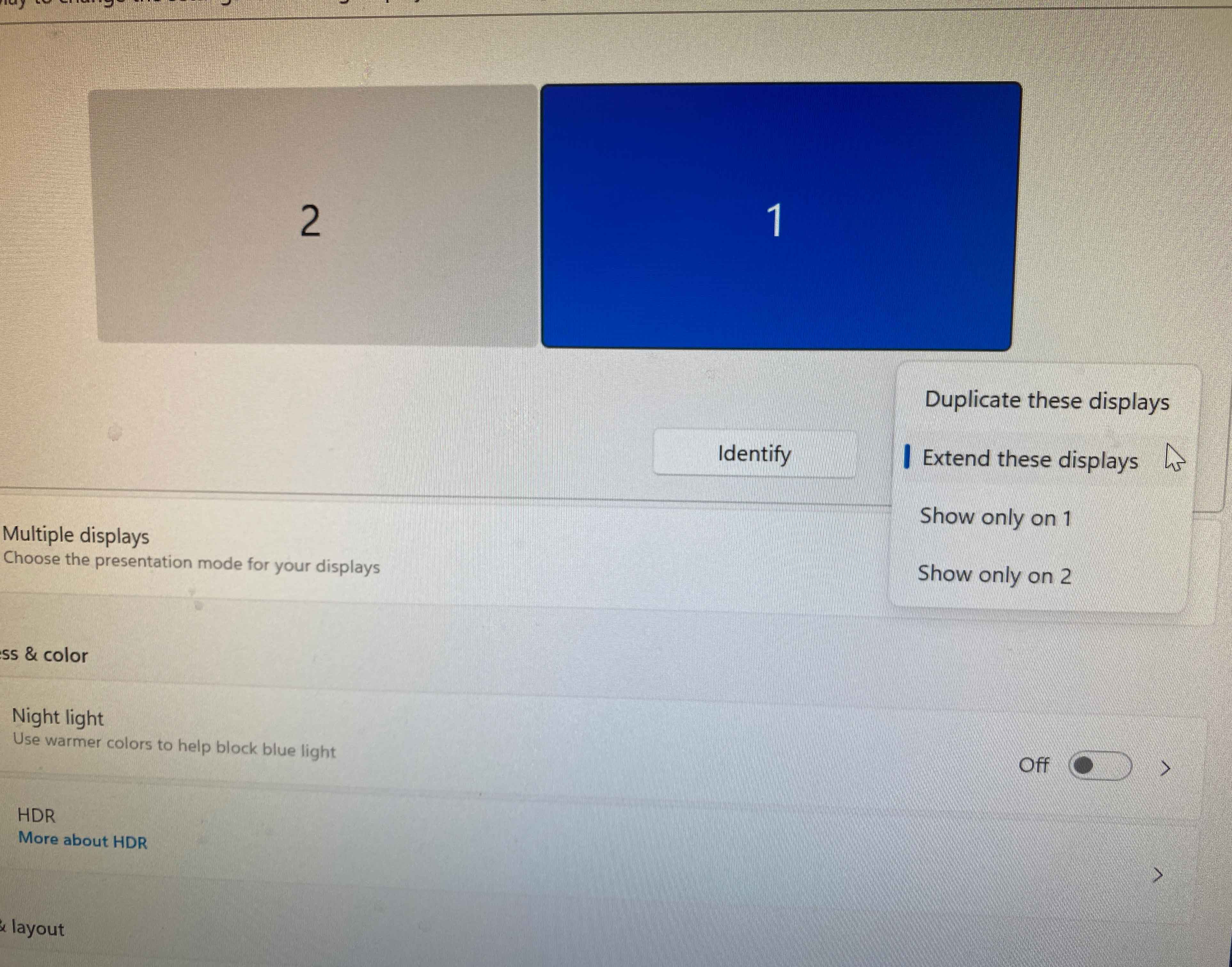

I did not turn off or disconnect either monitor. I simply dragged the Sigil window to the 2nd monitor and closed it. When I attempted to reopen Sigil it crashes. When I go to Display settings and move the #1 monitor to the left of the #2 monitor, Sigil then opens fine.
Does Windows Display Settings, have a "Gather Windows" button?
Not by that name...but I think you may be referring to the "Extend Displays" function (see attached image) that creates one large desktop where the mouse flows from the edge of one display to the edge of the other continuously via the orientation shown in the graphic. In the image you would move your mouse from the right edge of monitor 2 and it would show up on the left edge of monitor 1.
I usually have these monitors set to "Extend these Display"
