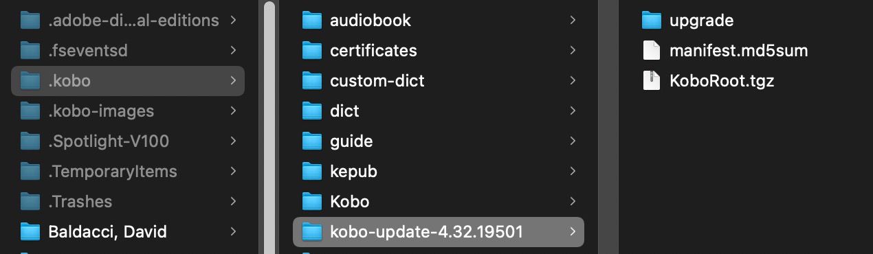

Yes, I did those steps and nothing happens after disconnecting from the computer.
Here is what my .kobo folder looks like:
You do not want a directory under .kobo for the three files in the firmware ZIP file. You want them in the root of the .kobo directory.

Attachment 193280
Thanks. Success.
