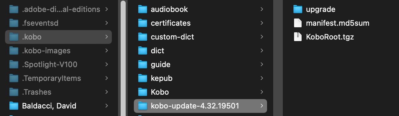

Yes, I did those steps and nothing happens after disconnecting from the computer.
Here is what my .kobo folder looks like:
https://www.dropbox.com/s/j8v6mfrp05...aphic.jpg?dl=0

You do not want a directory under .kobo for the three files in the firmware ZIP file. You want them in the root of the .kobo directory.
Thanks. Success.
