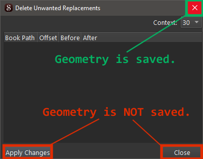

@KevinH: Look here.
Tested on the latest build including 1fc2a49.

@BeckyEbook,
That is strange. I will look into it. I would have thought the closeEvent would be invoked if accept() is called.
Edit:
Based on some debug output the closeEvent() is *not* invoked when "accept()" is used to close the window. I had no idea and nothing in the docs say this will happen as the window is closed if I use accept(), reject(), or done() so as far as I am concerned this is a Qt bug.
To prevent it, I replaced all accept() calls with close() calls to literally make sure the closeEvent handler is invoked.
Just pushed that to master. If you get a free moment give it a try.
