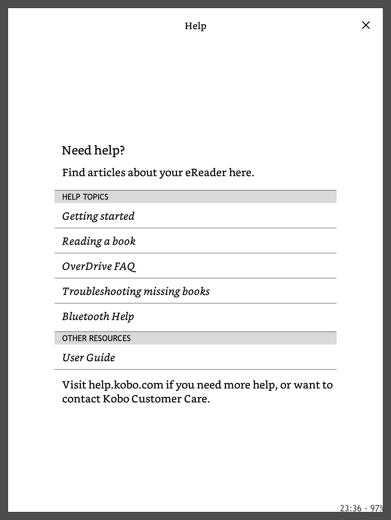

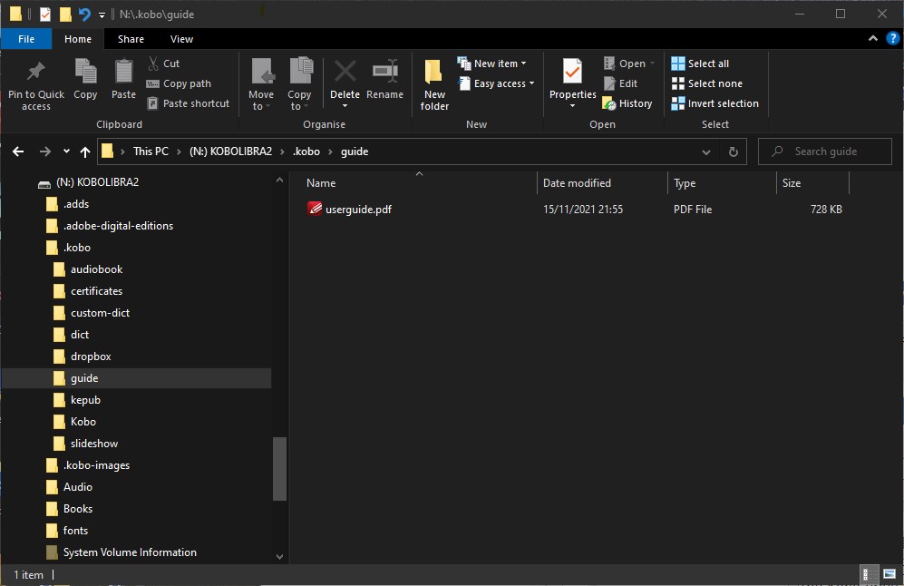

Originally Posted by BookCat View Post
Sorry for all the questions. I can't see anywhere on the Kobo drive to sideload books. I'm trying to put a PDF file (user manual) on the reader. I know this isn't a great format.
When I open the drive, I can see: ADE, Kobo, Kobo Images. If I look inside Kobo the only file which looks like it contains books is called Kepub. But where do I put non-kepub books, such as epubs and this PDF?
The User Guide PDF can be treated as a special case, see attached Windows screenshot. If you drag-drop it to
DriveLetter:\.kobo\guide\userguide.pdf
then you will be able to access it via the Kobo GUI, i.e.
More > Help > Other Resources User Guide
You will need to create the .kobo\guide subdirectory if it's not already there.
I did this exactly as suggested. I'm looking in More, Help, but under Other Resources it just suggests that I visit help.kobo.com or contact Kobo Customer Care!!!
Did you use the exact filename and subdirectory name I posted? Don't forget the Kobo is a Linux device, not Windows, and so, in general, case may matter, i.e.
.kobo\guide not .kobo\Guide
userguide.pdf not UserGuide.pdf (or any other original filename you downloaded)
If all else fails try a full reboot after you've copied it to the right place

Then I don't know what else to suggest because I've done exactly what I described on my own Libra2 and it works fine for me as you can see in this screenshot.
