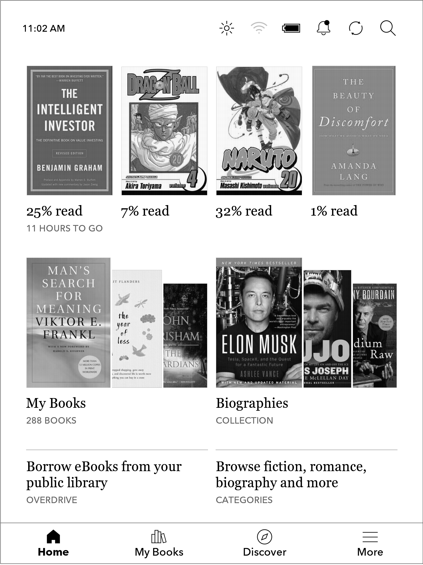

Last time I looked, the hamburger icon for the main menu at the top left was removed several firmware versions ago. Newer firmware has the home, my books, etc at the bottom of the screen. Do you see a clock in the upper left corner when you are on the home screen? What version of Kobo firmware do you have installed? Have you tried to install that firmware again?
Edit: added image of home screen

Well that would bring a lot of peace to my troubleshooting. There was a lot of features in that particular menu however and now it seems like I have hardly any.
Thank you so much for offering some feedback, however. I really appreciate it.
I never done any kobo upgrading previously or mod-ing. I suppose that's why it was that way. Hahaha. I guess that explains it then. But tell me what should be in the Menu now in the bottom right? Well bottom right now is Nickel Menu for me with just Koreader and Plato.
To left it says "MOre" that only contains "My wishlist, my articles, activity, beta features, settings and Help."
It seems rather sparse to me. Is that all there is in the menu now?
