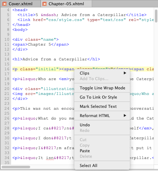

Okay, I have added a "Toggle Line Wrap Mode" to the CodeView pop-up context menu in my local tree.
See the attached screenshot with NoWrap set.
This will tentatively be in the next release and pushed to master once we are 100% sure there is no need for a Sigil-1.9.3 anytime soon.
Please note this really only helps show structure if the text does not already have inserted new lines in it.
This is the issue with the Alice in Wonderland test epub I often use.
So to make this useful in some epubs, you may have to use Mend and Prettify first so that ToggleLineWrapMode works as expected in these cases (as it replaces \n within p tags with a blank " " as that is what xhtml/html rules say should be displayed in these cases).
ps. This has now been pushed to master and will be in the next release.
