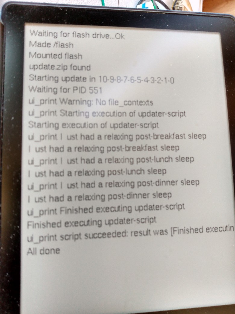

Wow that looks great... so I have a usb stick, I have the OTG cable, I have Update.zip... so what should I do now, that it does as in that picture?
I guess I need to get update.zip on the usb stick (any special format for usb stick needed? like fat32? should it be on a special folder?)
My Thought
1. plug usb c to PC
2. use the File I got to boot into the adb able recovery mode
3. unplug Poke 3 from PC and plug usb stick with update.zip into poke 3
4. what is the next step? or am I completely wrong?
DogilD is offline   Reply With Quote
Old 03-12-2022, 10:33 AM   #21
Renate
Onyx-maniac
Posts: 4,166
Karma: 19000001
Well, first you need a new recovery from today. The link is in the PM that I sent you originally.
Take your decrypted update.zip (You have used DeBooxUpd.py on the .upd file, right?)
Put it on a flash drive in the root directory.
The flash drive should be formatted with normal "Windows FAT."
You just need to fastboot boot p9mod
It will have the splash screeen saying "Onyx".
Wait until it turns all white. (Even though your PC has bonged to show you that ADB is ready.)
C:\>adb shell
When you do the next step, keep your eye on the display. It should flash white/black/white. If it doesn't, stop right there.
# start ttyscreen
Next:
# start autoupdate
It should say "Waiting for flash..."
Disconnect the USB cable from your desktop.
Plug in the OTG adapter/flash drive and cross your fingers!
Within 3 seconds it should start automatically. Keep your eye on the display. Use a camera to capture any error messages. It may be that we have to add a symlink or something before we run the updater.
Good luck!

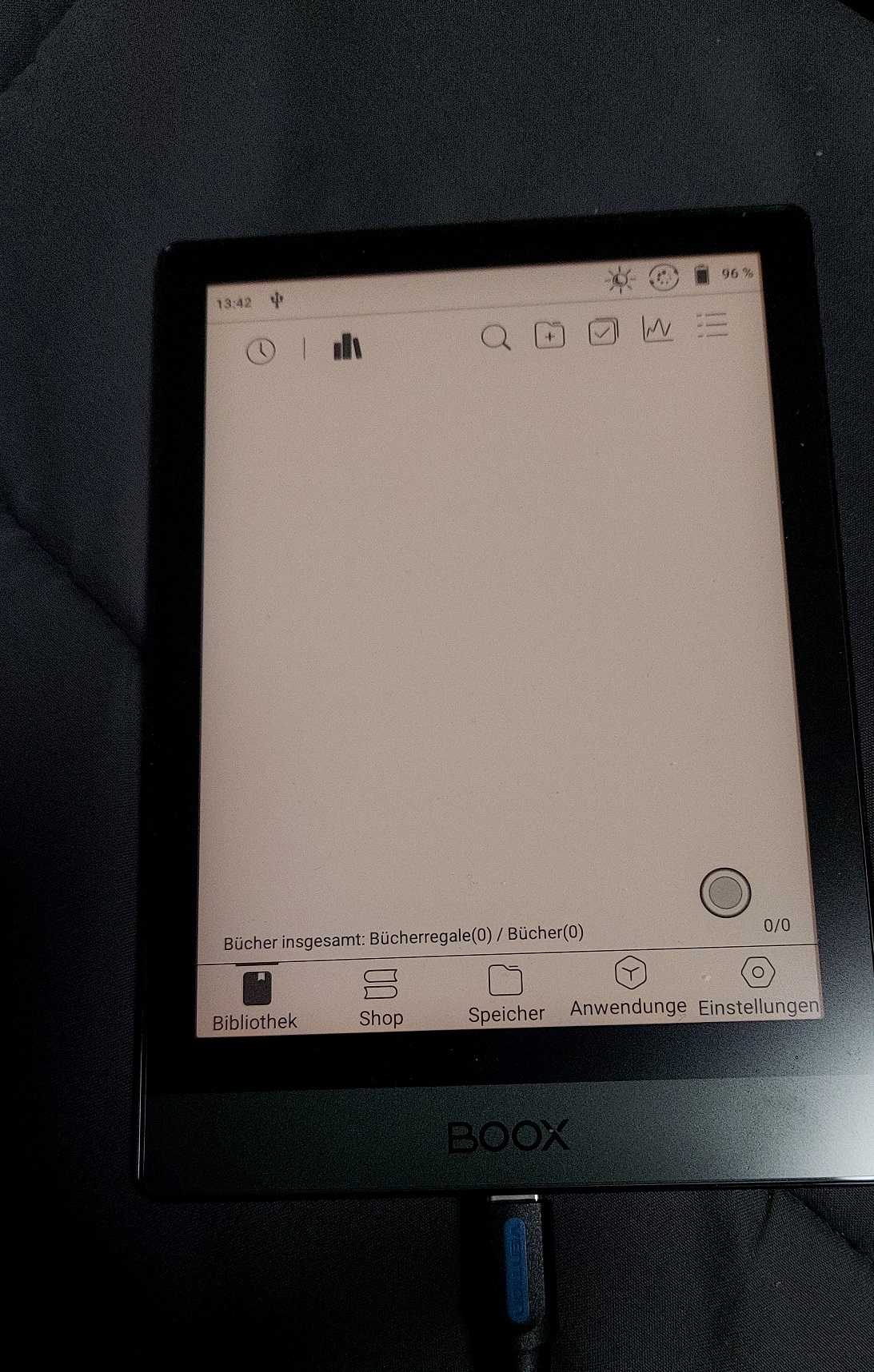

It worked! thank you so so soooo much.
Don't know how I ever can thank you for this.
testing if everything still works but seems like.
quick stupid question. can I now reboot and or turn the device off, or do I need to keep the device on?
anyway. thank you really much
Name:	Poke 3 Works again.jpg
