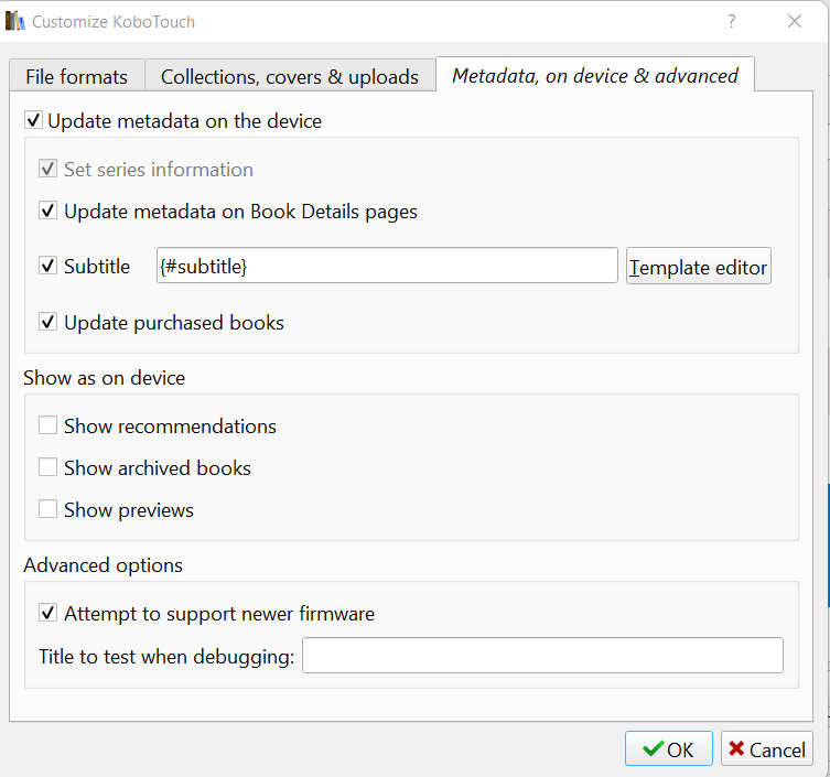

Follow the advice in the error message. Open the configuration dialogue for the KoboTouch (builtin) and/or the KoboTouchExtended driver and check the attempt to support new firmware checkbox on the 3rd tab of the configuration.
The first was ok but not the second.
I will try it.
Thank you for all.
