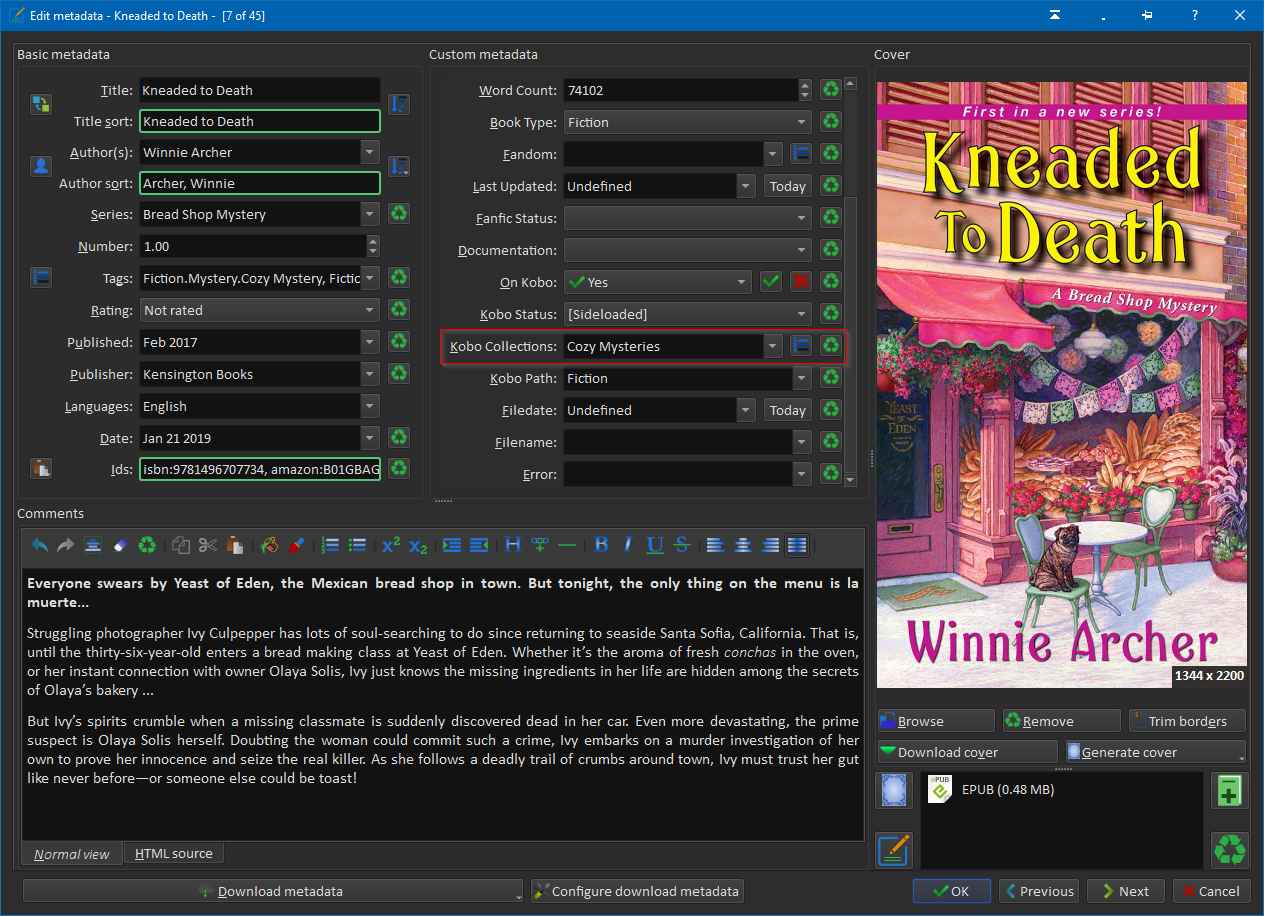

Re-importing wipes out the shelves/collections of any sideloaded books -- only Kobo Store ones sync to server. But you can use Calibre + KoboTouchExtended (I think also basic KoboTouch) to set a tag-like column for shelves/collections and that will update it when you connect.

Yes, this is to be expected. The list of collections/shelves is still in the database actually I think the list of shelves gets synced, but your re-imported books aren't assigned to them because Kobo had to rebuild that part of the database. Take a look and you'll see reading positions will have been reset too.
Calibre stores series data by default. But Calibre doesn't store any collection/shelf information without setting up the Kobo collection column. So if you don't have one, there is nothing for it to update.

Yes, this is to be expected. The list of collections/shelves is still in the database, but your re-imported books aren't assigned to them.
I promise, I am not purposely being obtuse here. But I do not understand what you are saying.
Collections worked fine on the Kobo until 4.31 caused it to crap the bed earlier today.
Now Collections are all empty.
I updated cached metadata which I thought would send the tag info back over to update collections.
If that doesn't work, what can I do to get collections updated, short of deleting all content from the Kobo and sending it back?
As mentioned, I already have Calibre set up to manage collections and have done so for years. Screenshot attached in my earlier post.

Unless you have a Kobo collection column assigned, it won't send the collection information, because the Calibre library does not have that information.
You need to create a tag-like column, add the info for your books, and assign it in your driver settings.
Then Calibre will be able to update it.
You need to create a tag-like column, populate it (bulk metadata edit is your friend here), and assign it in your driver settings.
I already have the Tags column assigned to send collection information.
Does refreshing metadata not resend tag information? I thought it did.
One more time, here's how I have KoboTouchExtended set up. Collections column is Tags
