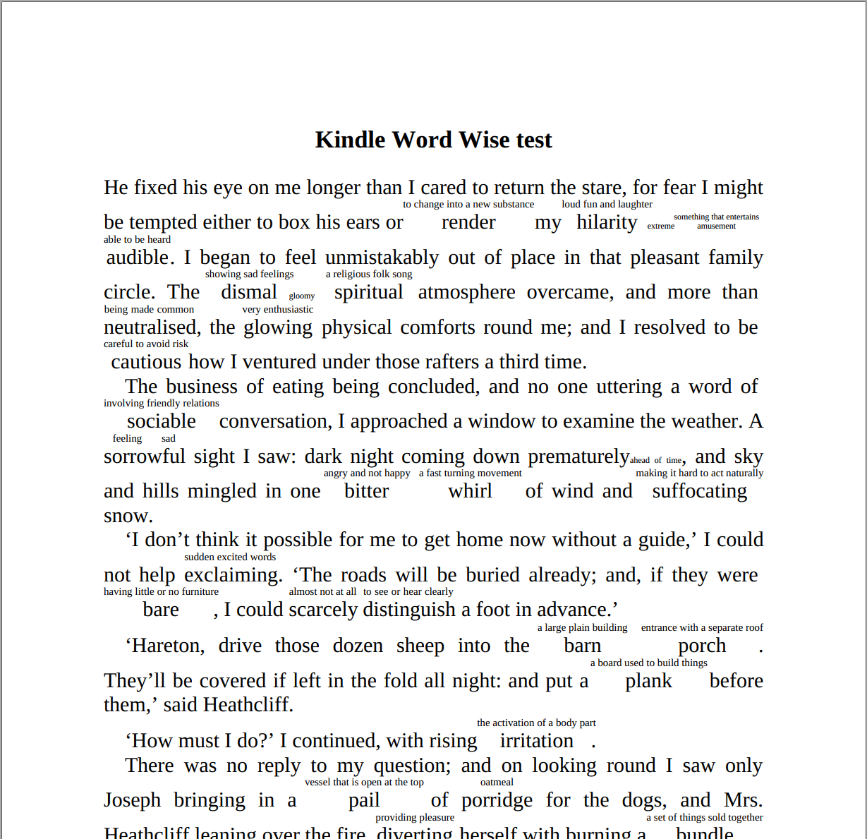

Hello everyone,
I've create a simple script to generate WordWise for all type of ebook. My work based on research of @m1lovanovt. Instead of generate Wordwise information for .mobi file (Amazone Kindle Format), I try to using <ruby> html tag to generate WordWise format on any type of ebook. There are some bugs still need to fix, welcome to your contributions !
Hope this script will help others love this Wordwise feature like me.
Here is source code https://github.com/xnohat/wordwisecreator
You need to have calibre on your device.
usage: php wordwisecreator.php input_file hint_level
input_file : path to file need to generate wordwise
hint_level : from 1 to 5 default is 5, 1 is less wordwise hint show - only hard word will have definition, 5 is all wordwise hints show

Thank for the tool.
I edited some style to add the bracket above.
However, we need to agree that it's still not perfect, hope you can to make it like real
Ref: https://jsfiddle.net/fgnp07ty/1/
Line 99-100: can use ruby or span data-tooltip
Line 117-119: add "--extra-css ./ruby.css" while converting

Dude, seriously can you make a tutorial how to do this?
I am considering buyin a kobo instead of kindle but Wordwise is holding me back
If this works with anytype of files and can be run on kobo It would be really awesome!!
