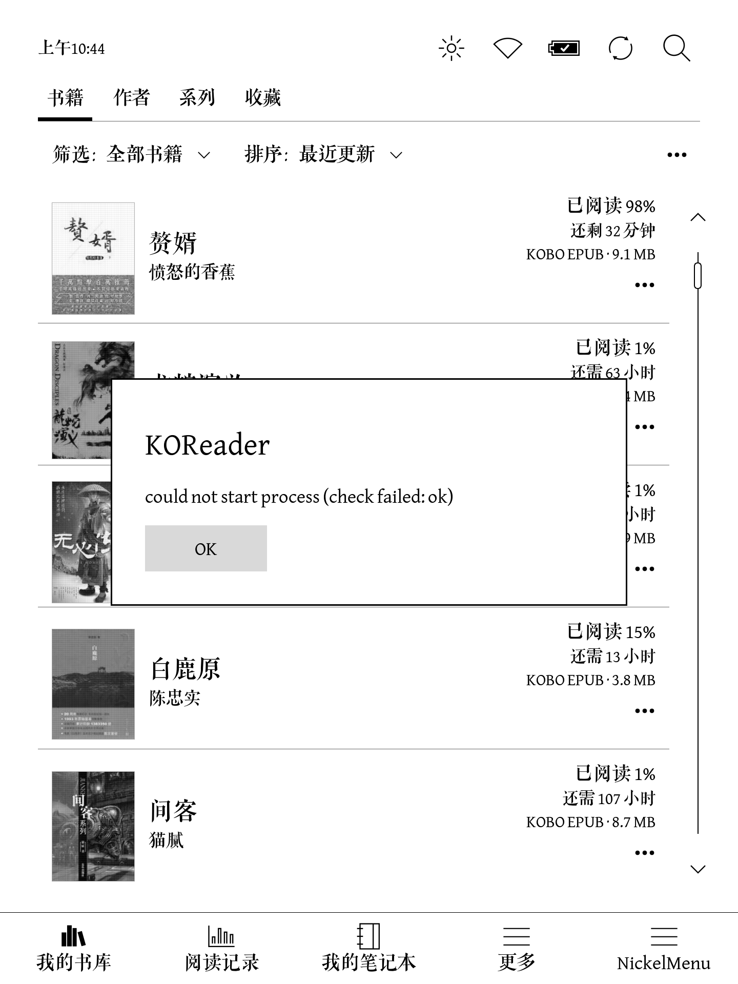

1.Every reboot,I launch Koreader perfertly,and switch on SSH,exit Koreader,keep reading
after minutes later,I will never launch Koreader till I reboot again.Nickelmenu gives me a popup as attached pic.(SSH service remains normal)
What should i do to fix this???
Koreader Ver:2022.1
Fw ver:4.31
NickelMenu:0.54
2.observe a unstability while I intall Nanoclock 0.11,device randomly crashes.
Sage with power cover.
If power cover removed,it seems normal
really feel BAD

Have you update the tools you are using the the version compatible with firmware 4.31? At the very least, Nanoclock has to be updated.
Yes,as mentioned,the newest version

No time to look into why QProcess would fall on its ass, so, just switch to using the KFMon generator, that should work (and if it doesn't, check KFMon's log, which should have a possibly more helpful failure message ).
As for NanoClock, it's a minor miracle that it even works on sunxi, so I would count my blessings .
