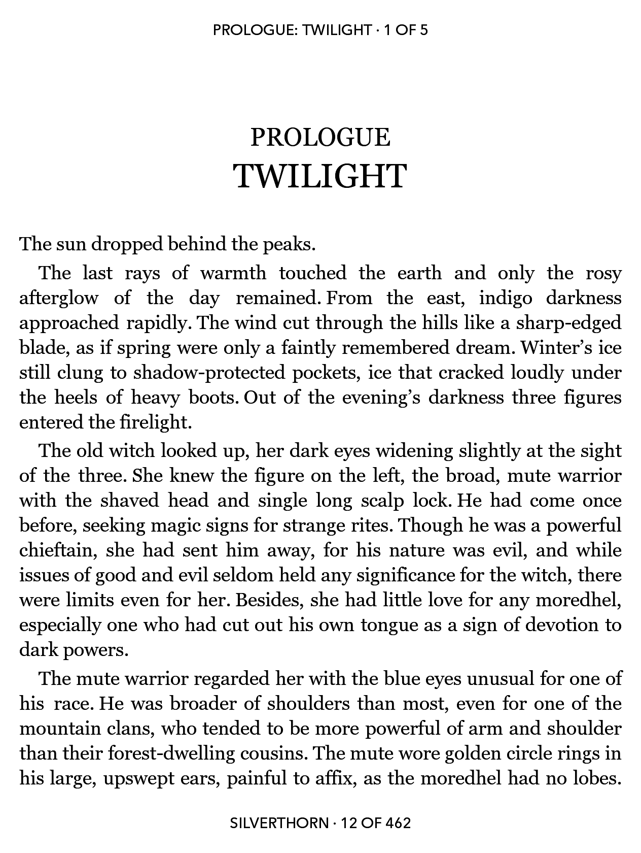

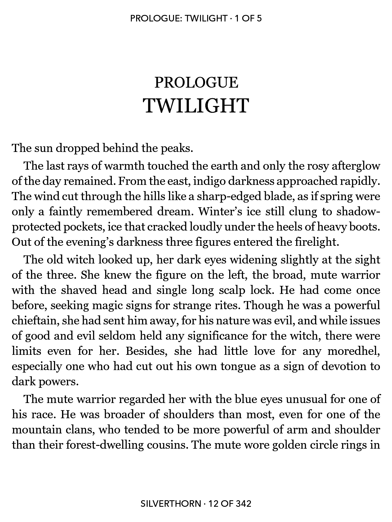

I'm curious if anyone knows what is going on with the word spacing in these examples? Specifically looking at the first line of the second paragraph.
The screenshots are as follows:
1. KePub with patched firmware (excluding legibility patch)
2. ePub (same firmware as #1)
3. KePub with same firmware as #1 + legibility patch
(Note: KePub was converted with KoboTouchExtended driver)
Here are my firmware patch settings:
Patching ./usr/local/Kobo/libnickel.so.1.0.0
  SKIP  `Allow USB storage even when device locked`

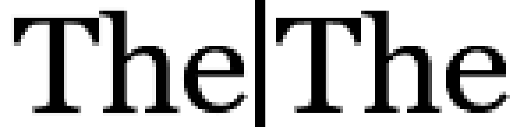

What I see going on here:
A. Extra spacing between words in KePub causing words to be moved the next line compared to ePub. Perhaps due to a minor difference in margins impacting line width?
B. With kerning (legibility patch) enabled there is extra spacing between letters in KePub compared to without kerning enabled. I expected the opposite: a reduction in spacing.
C. Maybe line spacing is larger in KePub than ePub? Not sure, but not too concerned with this.
Help is much appreciated!

The fonts aren't set to exactly the same size in the kepub and epub renderers. That is, I don't think that the "unify font size" patch makes both sizes exactly the same?
I zoomed in to the two screenshots and noticed that there is a slight shadow around the kepub's text (most discernable around the upper edges of 'T') which suggests to me that the font is scaled ever so slightly larger than the epub's thus causing "afterglow" to not fit on the same line.
This might also have a very minute effect on C (line spacing), as well?
Of course, the programmers know exactly what is going on with that patch and can let me know that my guess is wrong.
(kepub on left, epub on right - zoomed 1000%)
Name:	size comparison.png

In order to enable kerning, you have to make sure the font being used supports legacy kerning. You can use Fontforge to save the font with legacy kerning. See this thread on how to do it.
https://www.mobileread.com/forums/sh...d.php?t=259102
No, you really don't have to do all that. If you have included
text-rendering: optimizeLegibility
in the kepub CSS (via kobopatch, kobo_extra.css or any other preferred method) then kerning and ligatures will be used. See my old 2016 post with pics.
That may be true. @sherman had to completely rewrite that patch when it stopped working quite recently (4.28.xxxxx perhaps???) due to major Kobo changes. I believe it was a lot of work to get the epub/kepub font-sizes as close as they are without worrying whether they're pixel-perfect. Near enough is good enough
Given some of your kerning questions, I think it may be worth you reading the whole kepub vs. epub thread. It's only 3 pages of posts so shouldn't take too long. It's where the text-rendering: optimizeLegibility pros/cons were first discussed.

Keep in mind that both engines use *completely* different font renderers, so I don't expect a 1:1 pixel-perfect match, even for something "slightly" (he said ;p) more trivial as baseline and glyph blackbox handling to actually be technically feasible .
As a not-really-applicable-here, but highly interesting, and tangentially related read, see https://gankra.github.io/blah/text-hates-you/ .

As for the unify font size patch, there's no way to get it pixel perfect. My goal was to get it as close as possible, but the multipliers/divisors I have to work with can only be set in 0.25 increments. Also, as NiLuJe said, kebup and epubs use completely different font renderers.
