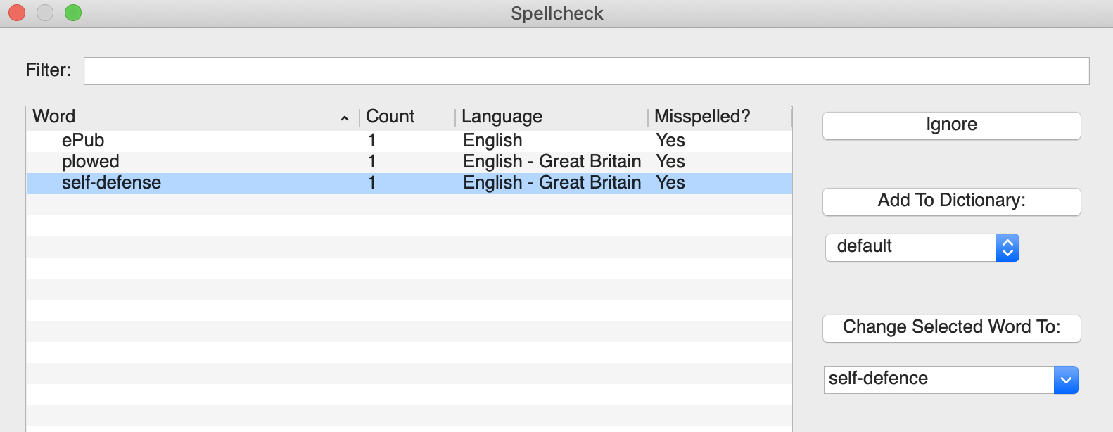

One thing I have noticed since using the new dictionary is that sometimes the suggested replacements for misspellings is a little off.
I came across self-defense in a book today. I thought that right clicking would bring up self-defence as an option, but I was surprised to see that it is not even listed. I also noticed that when using Spellcheck the suggested replacements is a bit off. I was offered just about everything other than ploughed when I went to replace plowed. |

Suggestions are really based on edit-distance which is roughly measured as the number of single characters changes.
So to go from: plowed to ploughed is actually quite far in terms characters added, swapped, and removed, which is why phonetic suggestions such as used by aspell help. As for self-defense vs self-defence, that is only a 1 character swap so as long as self-defence is in the en_GB dictionary then it should have made the list. I will check if "self-defence" is in the dictionary. |

We can handle plowed vs ploughed via a .aff replacement table entry.
ow -> ough We can add that. Update: Adding the ow -> ough to the replacement table in the en_GB.aff did the trick. But neither self-defense nor self-defence exists in any of the word lists from scowl. I think scowl appears to assume all words break on "-" but that is of course nonsense. That behaviour is up to the dictionary itself as not every valid combination of two words with a "-" in between is a valid word. So I added self-defence to my en_GB dictionary and added the replacement table entry and now get the following: See attached images. Please let me know if you see any other irregularities. Last edited by KevinH; 01-25-2022 at 12:13 PM. |
