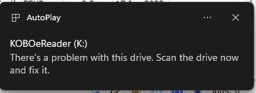

Originally Posted by DrChiper View Post
Since this version I noticed several USB errors during connection with my PC. The warnings were about a possible corrupt drive, after connection. No real problems were noticed. Kobo DB was ok. It always happens after the sending via calibre of epubs, disconnecting, and then reconnecting again to update the DB. Noticed on Clara HD and Libra H2O.
Update: USB connection is unreliable, though it seems not to corrupt the kobo DB as far as I can determine.
I decided to return to FW 4.30.18838 which seems to have solved the problem.
